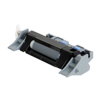

    Well, i think it's quite silly...
    Does the pedestal/lower drawer of a Irc 2020 Adv. have different paper rollers ? A colleague of mine said he couldn't swap the rollers from drawer 1 with the ones from the bottom drawer. The diameter was different...
    AFAIK all rollers are the same, even for al lot of different types of printers (5030/2380/2020/2220)
    I usually order :
    - FC6-7083-000 or FC0-5080-000
    - FB6-3405-000 (the small ones)
    - RM1-0037-020 (the blue ones) or FC6-6661
    Johan

    Have you ever seen the machine? T1 feed unit is a totally different technology!

      Irc 2020 feed sep rollers there are only two for the top cassette

        C1 Feed Roller FM0-3173-000
        C1 Sep Roller Unit FM0-1657-010

          Ok, sorry, my fault. I ment drawer 2 ofcourse, not drawer 1
          Ok, again : Does the pedestal/lower drawer of a Irc 2020 Adv. have different paper rollers (then drawer 2 or 3)

            Drawer one is different. The rest are the same as far as I know.
