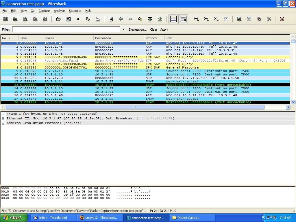

                    Ok, in an enterprise style network, that all seems fine and dandy! But what about the number of accounts that you have that do not use a server for their network activity?
                    In simple practice, yes, I agree that the admin should assign an IP. But what about the others that don't!? Outside of the enterprise network environment... I support the "DHCP Boot/Assign" method. I have done more than I can count and find no problem with it, in an simple network environment. Thank God for ARP!!
                    What the hell is ARP? Well cool then... Address Resolution Protocol - Wikipedia, the free encyclopedia
                    for the sake of techy talk... what say you?
