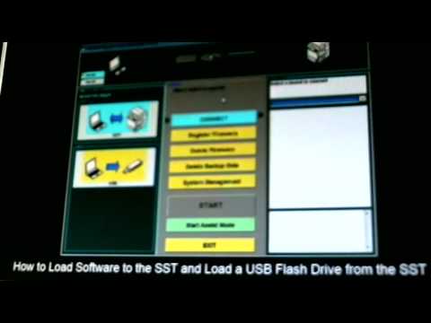

            Re: Canon firmware upgrade procedure ir 3225 black&white
            Did you export the firmware to your usb flashdrive using Service Support Tool?
            • wingit
              • Feb 2011
              • 84
              No, Is That what I am missing then. I was sent firmware via drop-box, I thought all I had to do was unzip to a new folder and pick the yellow folders after extracting zip.
                  OK, Thank-you , That,s what I am missing. I thought the thumb-drive came with every thing on it. Plug & play.
