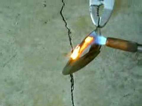

          Formatting those HDD will not erase data stored. It will be label as ".old" & compress/move to certain cluster in the HDD. Data is still retrivable. Use the advanced "Zero" or "DOD" method to bring the HDD back to its original factory default conditions. Use/perform with CAUTION...!!!

              Newer machines have come up to speed addressing security issues with the optional Data erase kits available , but on your model - even having your Authorized Canon tech format the drive with the service support tool only deletes the File Allocation Table and the rest of the hard drive data storage area is not overwritten.
              There is a security kit A1-P available for your machine for like $550.00 or you can as mentioned before - purchase a new drive and destroy the old one. -------probably easier.
