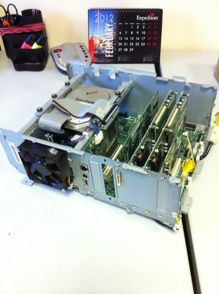

            Re: Canon iR2880i E748-4311
            Just been through images on my phone and I came across this. Hope this helps.
            Have you tried turning it off and on? No...Oh, it works now!
            • teckat
              • 16083
              From the top down
              #30-1-R-A PCB ASSEMBLY or OPEN INTERFACE PCB
              #31/32-2-PDRM-EF-A PCB ASS'Y(S) = two of these
              #33-3-SJ-A PCB ASSEMBLY
              #35--??? LANBAR-C PCB ASSEMBLY - is this out
              #34--???
              -RB-A2 PCB ASSEMBLY/ on side
                Yes I believe it is out...
                This is a cage I took to the customer to replace. This didn't work. The one in it didn't work. And I've tried a 3rd cage which isn't working either! All the same error code. Could this be a problem to do with the DADF??
                  this error has nothing to do with DADF
                  Do u Have the RB-A board that goes in that vertical slot behind the HDD ????
                  SHOWN WITH HDD REMOVED
                  E748-4311 is an error in the detection of the Sub RB-A board, which is located to the left of the hard drive
                  [2] Main controller PCB (sub RA)=color space conversion, rotation for electronic sorting, binary
                  processing, resolution conversion
                  [3] Main controller PCB (sub PDRM-EF-A)= image processing for printer output (color space compression, background removal, LOG conversion, direct mapping, color balance, zoom fine adjustment, gradation conversion, screen processing, framing, add-on)
                  [4] Main controller PCB (sub SJ-A)= scanner interface, scanner image processing (resolution conversion, image rotation, compression/expansion)
                  [5] Main controller PCB (sub LAN-bar-A)= LAN connection, HDD controller, HDD power supply
                  [6] Boot ROM stores programs used for booting
                  [7] SRAM PCB retains service mode settings and HDD control information
                  [8] DDR-SDRAM retains program data and image data temporarily
                  [9] Main controller PCB (sub RB-A)=(to be translating)
                  HDD HDD stores system software, retains image data for Box/fax functions
