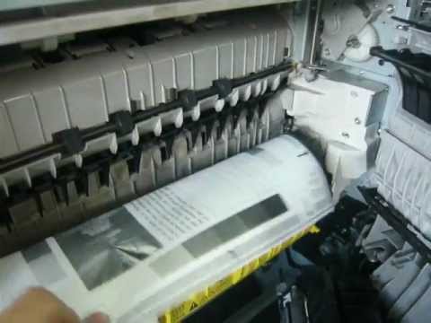

    Hi, kindly advise me how to isolate my problem on iR4570. The problem is paper always jam only in duplex mode but on single mode it's okay. The Jam Code is 207 i think PS13 is okay because i have no problem on single mode. Kindly see the link. Thank you very much.

                I noticed from your video that there are no sheets attached to the right hand door, below the auxiliary feed rollers in the 3rd delivery assembly. If the jam only occurs on duplex, it's quite likely that paper curl is causing the lead edge to catch the underneath of these white rollers when exiting the fixing assembly. Part number for the sheets is FC8-0959-000, quantity 4. Try fitting those and see if there's any improvement.
                  hi, do you have an image of the sheets that you mentioned? Maybe that's the problem. Thank you.

                    Here's an image showing the 4 black sheets in their correct position...

                      As the others have said this is a simple case of poor quality/damp paper as I can see from your video the paper has curled on the first side, curled paper will jam in the fixing unit.
                      This model is bad a feeding damp paper esspecially duplex.
                      Try thicker 100GSM if you have any or failing that open a new paper of paper

                        Problem on this thread was solved on the sheet suggested by Dan Dryer, Thank you very much . I have new duplex problem but on a different machine. The paper jams on drum unit. (see image)
