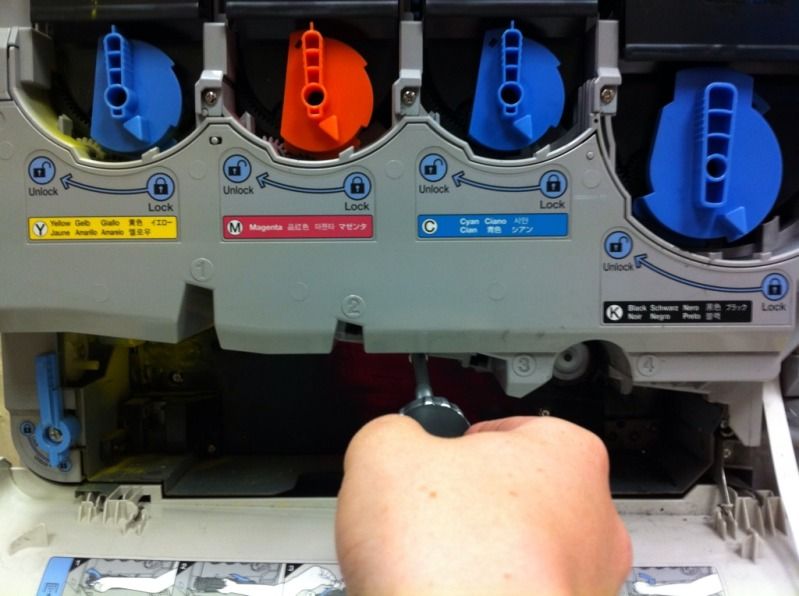

    If you arrive to a machine that has the "Insert Waste Toner" message displayed, yet the waste toner container is either new or nowhere near full, then this will more than likely sort out that issue.

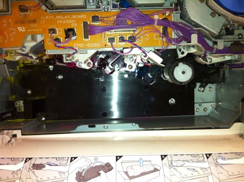

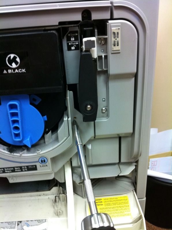

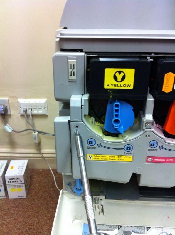

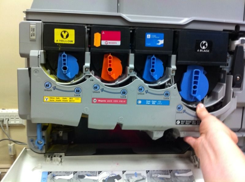

    Firstly you need to open the front door and take off the cover that is on the right.
    Then undo these three screws:
    And the one everyone always seems to forget:

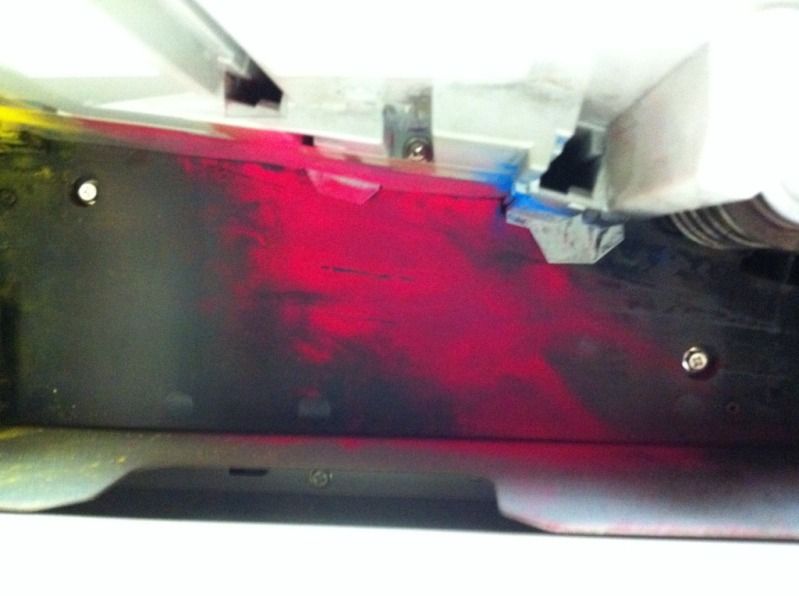

    Next you need to remove the cover that the screws were holding on, it simply pulls away.

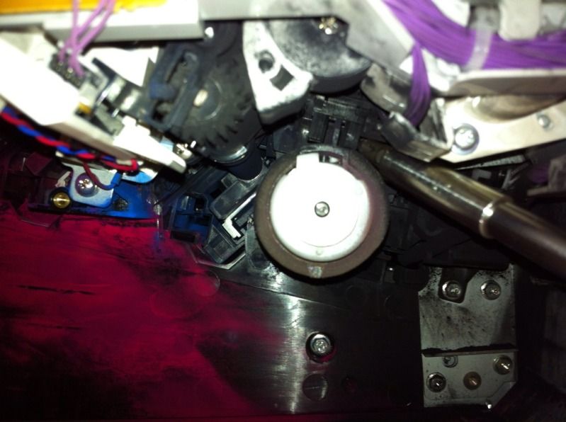

    And finally, the light interrupting sensor you're looking to clean is here, chances are toner is blocking it causing the machine to think there is no waste toner container.
    Hope this helps,
    JamesU.

        Or without even un-doing a single screw a good blow in the right place using a drinking straw does the trick!
        • Jamesu
          • Mar 2012
          • 101
          Re: How to: Fix "Insert Waste Toner" - iRC2380/2880/3380 etc.
          I guess that would work too!
          But to stop the problem coming back again so soon wouldn't taking the cover off be the better option? As i've had quite a lot of toner resting on the inside of it

                              If you want to deal with the e990 after sure go for it. Not recommended at all. Ps11 is a lot easier to clean physically than the e990 sensor in behind the cyan toner feed assembly, easy to take off quite a pita to get back in place properly.
