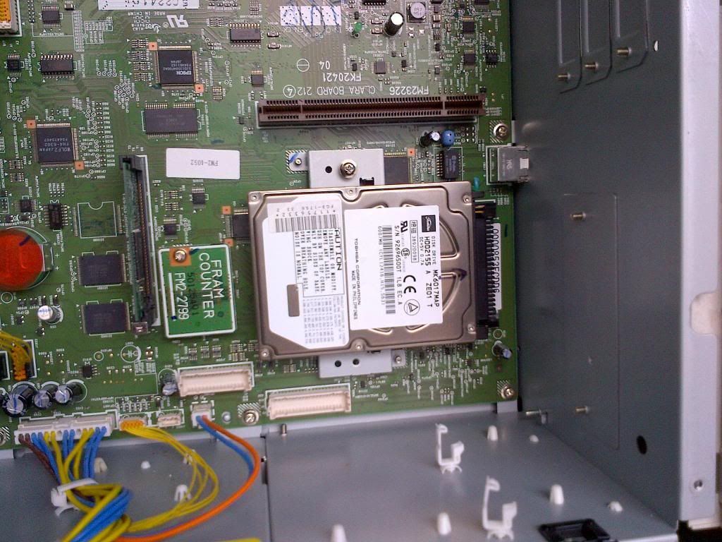

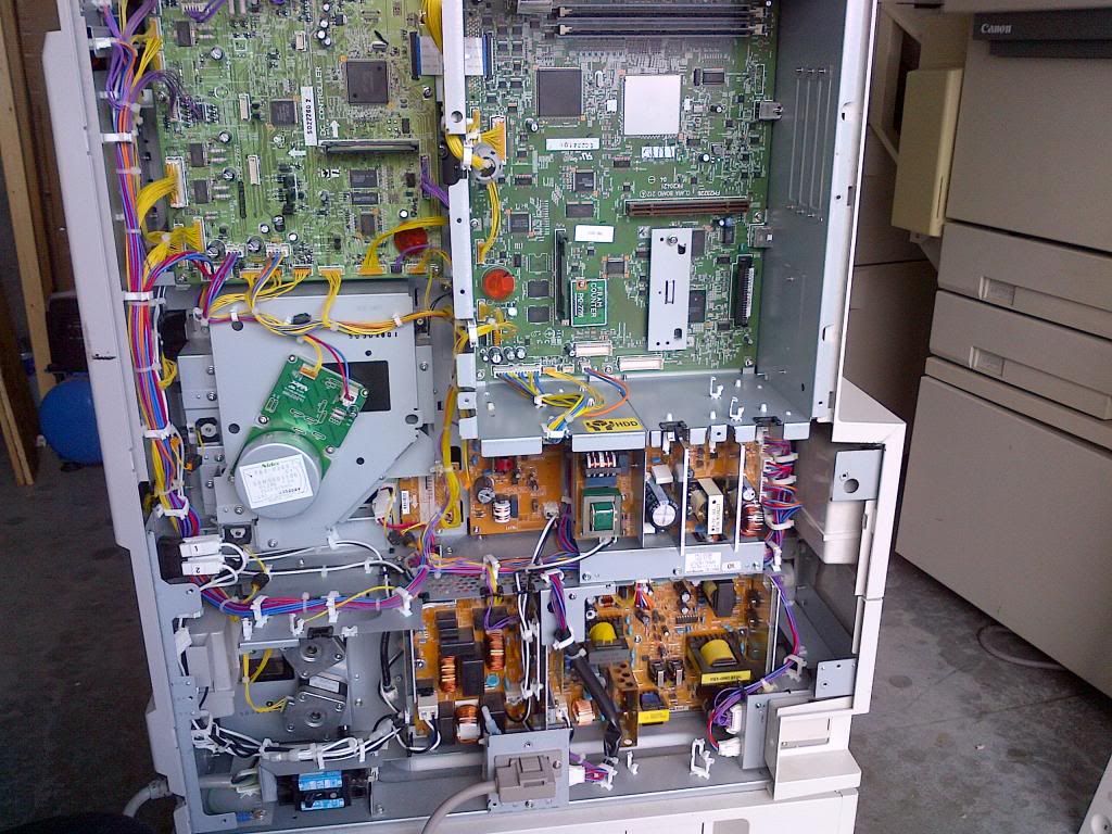

    So I bought this copier from my lease end dealer and as you can see there is a hard drive missing from this copier which probably explains the E602/001 code.
    I happened to have a hard drive from an ir4570 cannibal machine, at least I think it is. So why does it not just drop straight in as it should?
    here's a closer look at the hard drive.
    I've never really installed a hard drive into any Canon copier, though it's funny but I've been doing this racket for years and years so any help would be greatly appreciated. Thanks,

      Re: imagerunner 2870 with E602/001 code
      Apart from the holding aspect, does the caddy do anything else that would cause the hard drive to not be read? Perhaps does it maybe also jumper those final 4 pins on the drive?
      Ron
      • Canon.Tech
        • Mar 2009
        • 335
        Yes the caddy is just a holder nothing more. You can't fit another HDD from a different model unless it was an identical model etc.
        you'll need to reinstall the system software on that HDD to use the machine.
