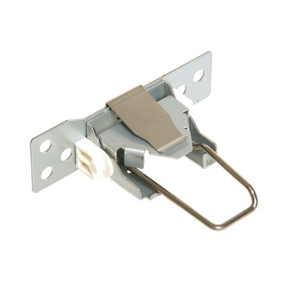

    Ir 4570 error e000-0001 I replaced 2 fuser, DC controller and still have the same error any ideas what can be the problem

    u obviously did an ERROR CLEAR
    -Door Switches> checked or replaced/working correctly-
    -AC DRIVER PCB [FM2-0260-000]/ *AC Driver is part of the MAIN POWER SUPPLY PCB ASSEMBLY
    -See if the latch catches when opening the Main Right Side Door
    this can be remedied by adjusting the cover that can interfere with the fuser release (1 screw ) (this cover is added when installing the internal finisher). The common mistake in the field is to bend this latch instead of adjusting the cover.
    >Problem may be that> the latch that releases and applies pressure to the fixing film is bent causing this mechanism to work erratically (proper and improper pressure when the Main Right side door was closed ).
    Solution was to replace the latch which is formally called the Hook Holder Unit;
    Part # FM2-0355-000

            I was also wondering if anyone could offer more info on which cover (1 screw) I would need to adjust? I have a canon ir4570 that has a problem with the main right door not wanting to open and I have replaced the door, the entire fuser unit and the hook holder unit (latch) also and it still does it no mater what.Thanks
              did u try to adjust the top leaf clip pressure (shown as brass color in pic )
                I didnt adjust that pressure because it did it with the old hook latch and with the new one. Do you think I should still try to adjust that?
