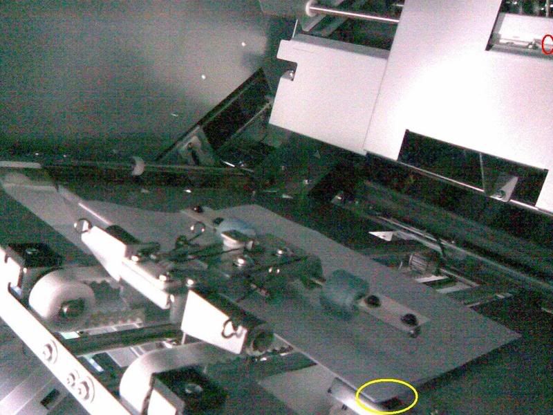

    The motor is working, in fact the start-up tests don't return any fault codes and it all looks normal. Once a folded booklet has been stapled and flipped over to the postion in the picture above, it should be driven down into the trimmer, but it just stops here.

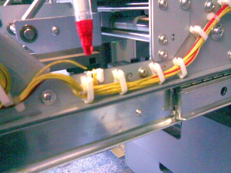

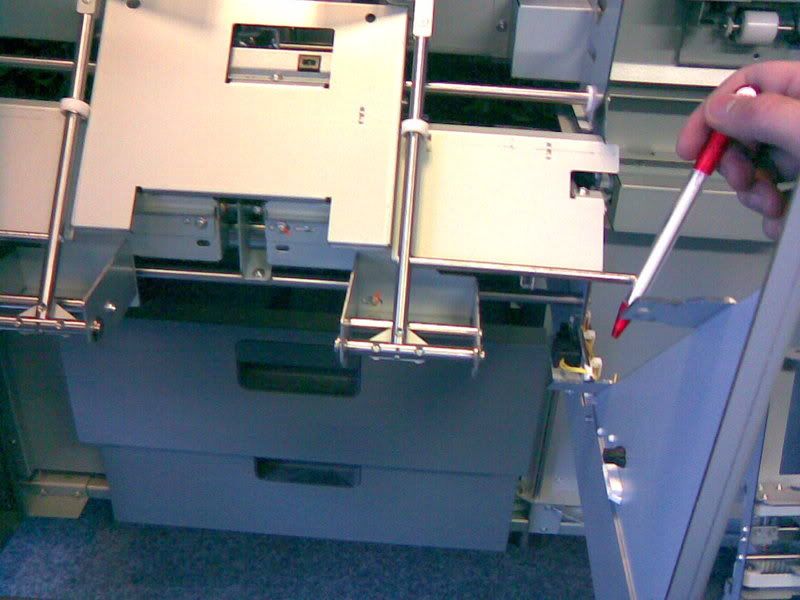

        Ha, ha!!! A broken wire. I am not sure how it came to be so broken, but re-connecting it solved the problem. I tracked it to the photo sensor that recieves the booklet as it comes down the chute. I don't know why the machine didn't return a permanent error code.
        Here's 2000 words worth of pictures:
