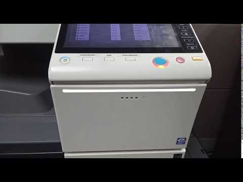

    This second hand recon BizHub C364e have latest firmware update.
    And "Secure Print Only" enabled.
    Recently, it will have all jobs hangging inside the machine with "Saving" and I need to restart the machine for the machine back to "normal".
    During this hanging time, I cannot access to the web admin, cannot send in new print job, cannot perform copying.
    I do suspect is their network problem, because printer is connected to a unmanaged switch and around 20 people is using this printer.
    May I have your help on this ?
    Job in Status "Saving"

            We found that during the machine is receiving the file, there will be error "Connection Time Out" which causing the machine keep repeating receiving the file process again and again.
            What we do is setup a printer server and send in job in 5 mins interval. Customer are able to accept our solution.
