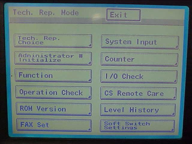

    • EbolaSandwich
      Originally posted by TheOwl
      You need to go into service mode and from there enter into security mode. You can then set the keycounter from one of the menus in there which will disable the copier until your external counter fires up the enable pair of wires going to the copier.
      I was not able to find "Security Mode" or any menu which disabled the machine, and I could not find anywhere to utilize an external key counter.
      Is "Service Mode" and "Tech Rep Mode" the same thing?? [yes, I'm new to this machine ]
      Here's the menu I get when I enter Tech Rep Mode:
      • Juggy
        Technical Support
        • Sep 2007
        • 101
        press stop 9 at this menu you will get into the mode
        • EbolaSandwich
          That's it!
          Thanks to both of you.
