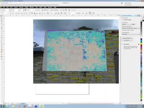

      They probably do not have Corel setup correctly.
      Corel drastically changed their color management with x6. Try setting the color management in the print dialogue to the Fiery in corel.
      I suggest that you have the customer buy a copy of David Milisock's book that explains things.
      I couldn't seem to find his book, but I know that Corel sells his book and here is a presented by him (I have not watched it).
      Here is another document for x5 that might help explain certain things here
      There is much more that could be said about internal software color management (e.g., Corel & Adobe) for production, but I hope I provided enough direction.
