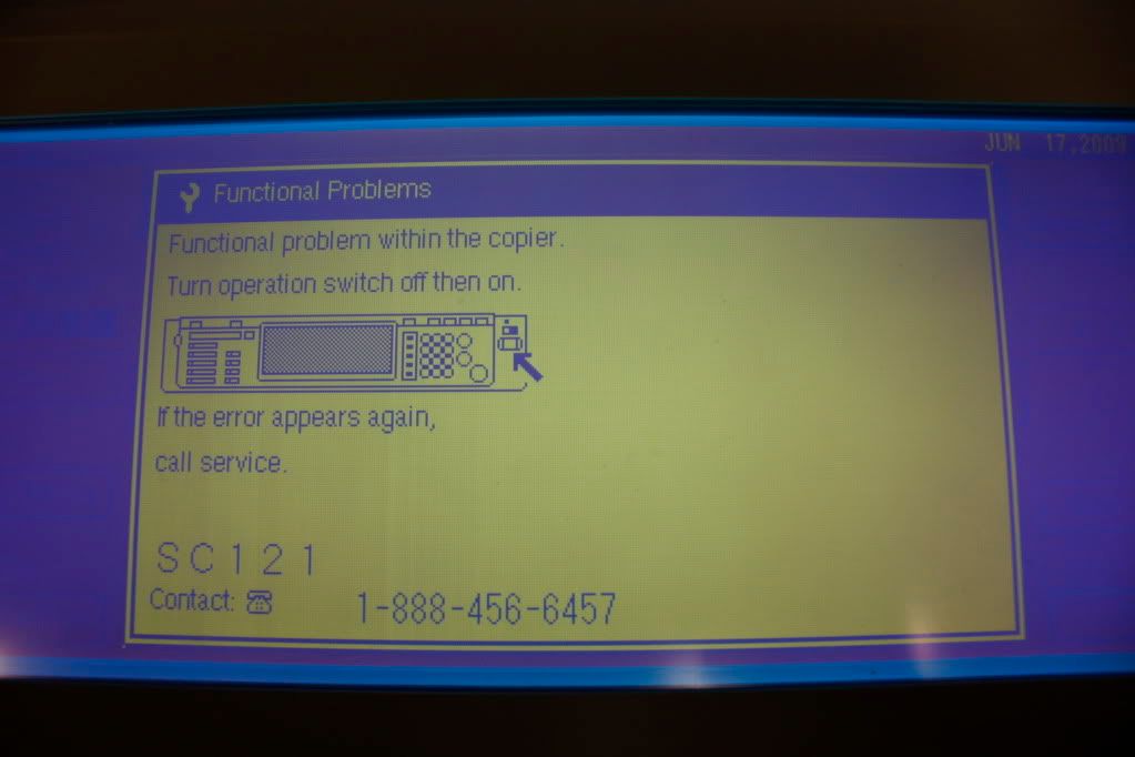

    RICOH 2232C Scanning error SC 121
    I just got an error message SC121 on the RICOH SCANNER I looked up the error message and it seems that I cannot find what error message, here is a picture of the error message on the screen
    have any of you guys seen this before I usually only see SC 122
    Thanks

    sc121
    Scanner HP sensor does not detect the off condition during initialization or copying
    Scanner HP sensor defective
    Scanner drive motor defective; Scan I/O or SBU defective
