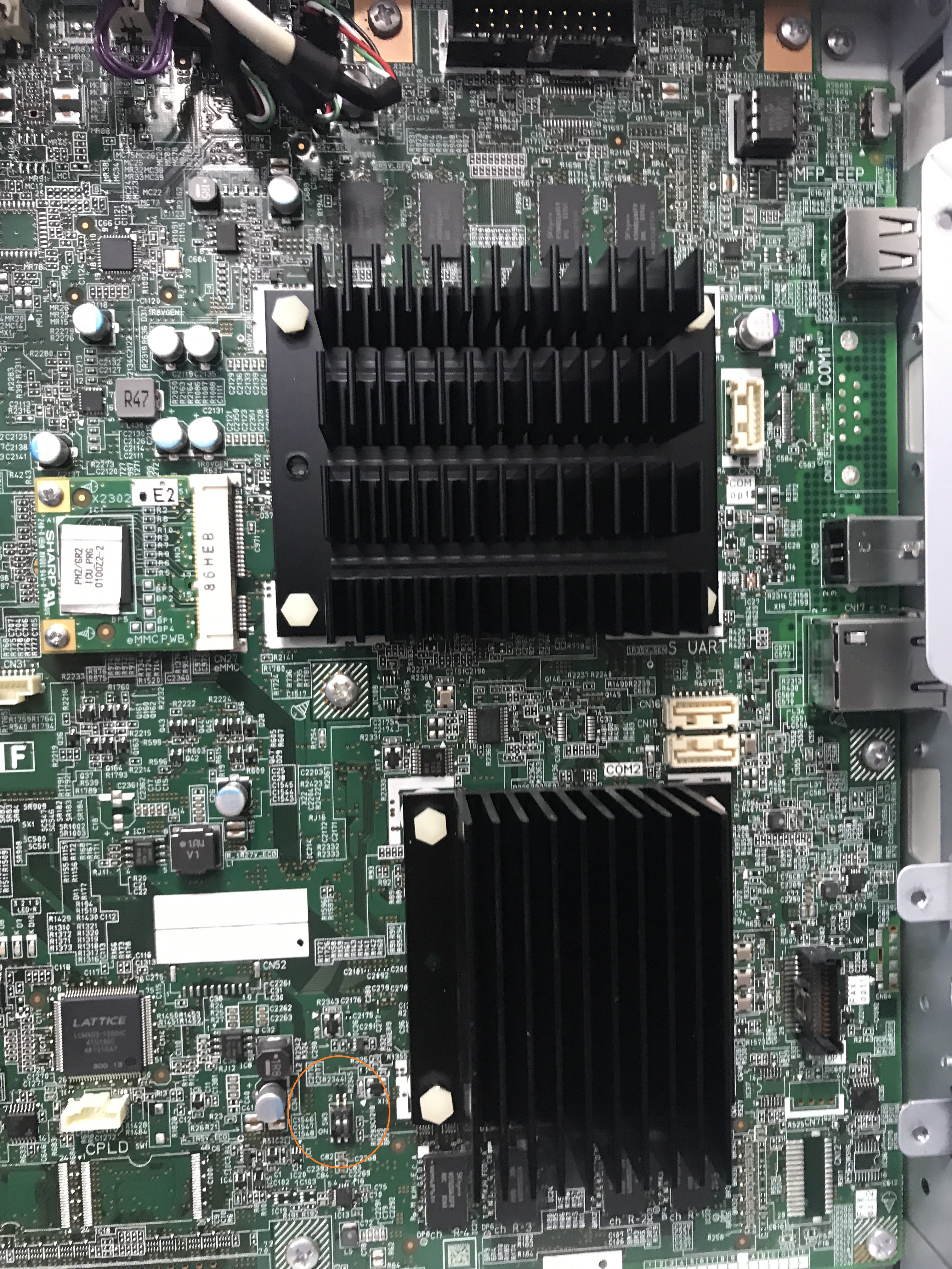

        Excuse us fellahs, but what did you have to do after switching switch no1 up - could you use SIM24-30 again?

          Re: MX3140 password reset
          I've just noticed that the switch we found was SW3 and not SW1 anyway which we can't find at all.
          Here is SW3: https://www.berkshire-computers.co.u...es/3071pcb.JPG
          SW2 is top right, where is SW1 on a 3071 - does anyone know?
            Sharp removed the SW for the later models, you either have to request a PW reset code from Sharp; or, do a Storage Backup from another device (admin password is stored within).
