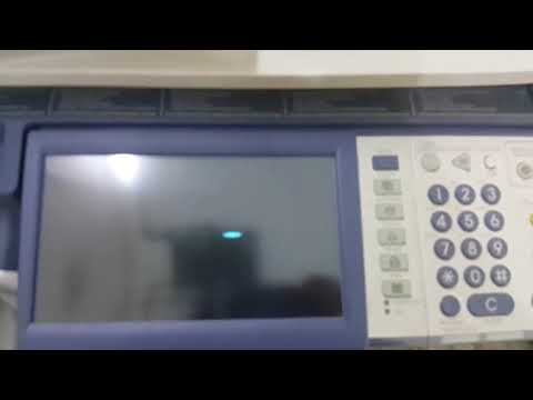

    hi
    i have a estudio 256 when turn on only show this page and no work
    how i can disable or reset this page
    i try wirh 4+8+9 and code 8929 and 9081 and c+3 number 8 and update firmware but stay yet .
    please help me
    thanks

      Re: estudio 256 need key
      After that perform 08-9030 (firmware init)
      and 08-9083 ( NIC reset)

        thanks remove user and password but when power on show this
        please see this video and say i should do ?
        thanks again

            Ah, I see that screen a lot on my rounds.
            You have a machine that has PaperCut Embedded installed. Formatting the harddrive will not full remove the software. There are 08 codes that were set that need to be reversed.
            Here is a link to the install manual, perhaps you can do it in reverse to revert your machine.
            https://www.evernote.com/shard/s503/sh/e02c1cb2-2931-41c7-bd98-1d74d55d69f8/3b56b9939a8a1227831158b73835dd45
            good luck

              Why not just disable the user authentication via TopAccess?

                      Well video shows the machine in ready state,so whats the problem

                        I should press key copy if no press only show four line

                          Try to do 08-9090

                              I do 9090 but no different
                              After 4 line show this on screen
