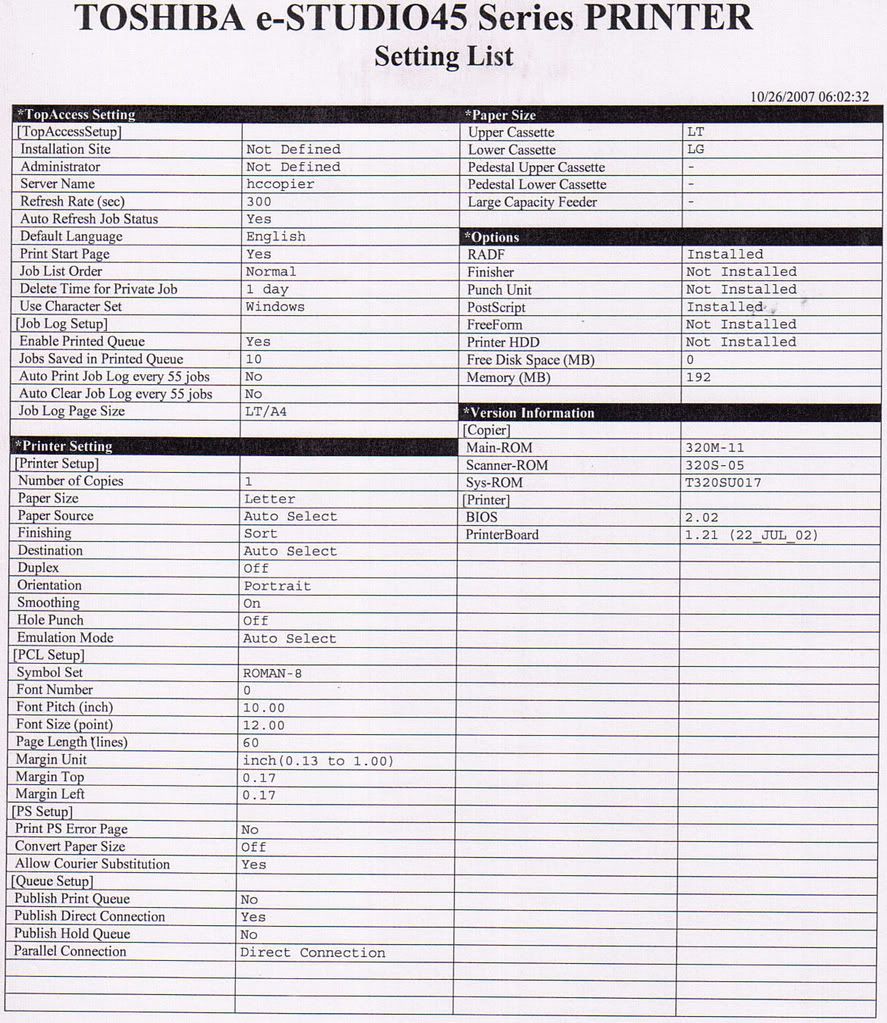

    Hi eveyone:
    I have a copier (Toshiba Studio 45) connected to my PC, but everytime I want to print, the copier prints this page:
    And it makes me spend lots and lots of paper in an unnecesary way.
    My question is: How do I disable this function?
    Thanks for your help.

    Log into the machine via ip address (top access) and turn off the start print page.

        I have the same problem, that our e-studio 45 - which is not connected to a computer - prints out the "setting list" every time it is turned on. Is there any way to disable this printout through codes?

          Yes, you hit Print/network-On/off-setting-Admin-(password if required)-Top access and disable startpage

            Thanks for the reply, but when i enter printer/network, on/off the only choices are "online" or "offline". How do i get to "settings"?
            • imaginGuru
              Top access is available from a PC only.
              once connected enter the IP address of your copier in the PC navigator, check all the options the menu displays and there you'll find the disable function for that.

                Press the offline then wait 30 seconds then the settings tab should appear.
                Or plug in an ip address hook a computer up to it and go into top access and do it that way.

                  Press the Printer/Network key. On the touch screen, select the SETTING tab. Select the Top Access icon. You will go through 5 set-up options. The 1st will ask you to enter the controller name. Just hit the Set button if you don't need to enter or change it. You will next be asked PRINT START PAGE. The default says yes, change it to no and press SET.

                    Thank's spock - i hit online and then offline and the settings and utilities menus appeared and i was able to get into top access and change the setting.
