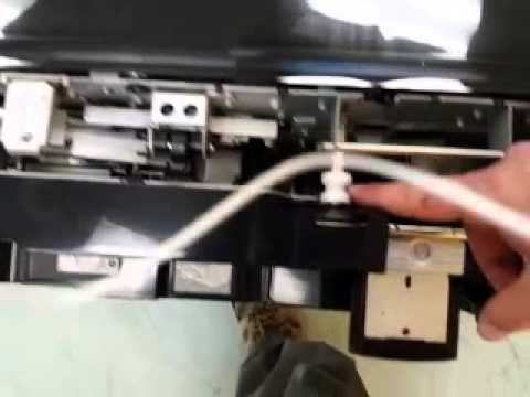

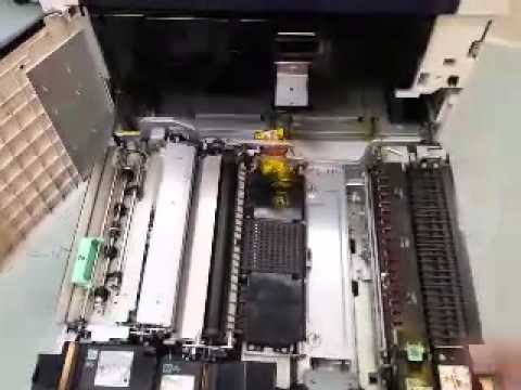

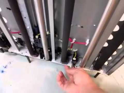

                    • InterfaceP
                      • Jun 2013
                      • 488
                      Re: DC250 - belt edge error reoccurs after setting NVRAM
                      In IO Check enter 042-200 manually rotate the belt one cycle. Watch for the "Value" to go from low to high. On the right side of the IBT assembly is a small black gear just above the larger white one. Insert a screw into the end of the metal shaft protruding from the black gear. This will allow you to rotate the belt.
                      These are old Videos I made but them may be of some help.
