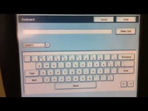

      Every color machine of this scale needs setup and calibration. I never seen one of these machines, but i bet you would have to have a scanner calibration sheet or package for reference and auto calibration.
      Here below is a video link for the calibration.
      Here is the system admin guide
