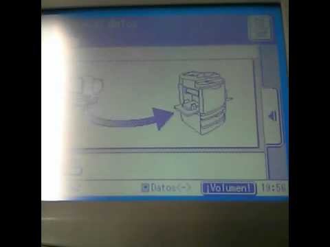

        Re: RP 3700 problems installing
        Originally posted by Press
        Thanks a lot Jeremy for your reply.
        Here there's a video of the machine receiving data. After doing this, it goes back to Stand-by (in spanish "Reposo").
        Thanks!
          If I'm not mistaken, your problem might be in your connectivity, if you are using an USB/Parallel switch the communication is getting lost and will put your riso in reposo or stand by. You might be better off with the NIC card. I got one brand new with CD if you are interested. .
                Muy buena suerte con su Riso.
                We're still trying to find out some alternative solutions. It would be helpful to know how much would it cost to buy the Nic card from you, as it seems this could be the only solution. We found out in several forums that many people were able to print with this same RP without the NIC but just using the Parallel port to USB cable. Anyway thank you very much for your help and suggestions!
