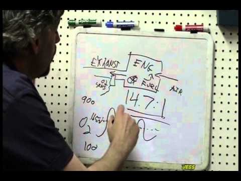

                    Anyone familiar with Fuel Trim? This has to do with air/fuel mixture. If there's too much gas vs. air, that's a "rich" condition and the catalytic converter can't burn off all the C02. If there's too much air vs. fuel, that's considered a "lean" condition and again the catalytic converter can't burn off the C02 as efficiently. There's usually 2 C02 sensors. One before the exhaust goes into the catalytic converter and another sensor behind the converter to read C02 after it's passed thru the coverter.
                    The computer strives to keep a perfect balance of air/fuel for burring off the most C02 in the catalytic converter.

                        We're getting deep into Fuel Trim and it gets even more complicated. There is SHORT TERM fuel trim and LONG TERM fuel trim. Any good mechanic really needs to master the fuel trim concept. This video explains it well:
                        PS - If anyone watches this video and truly takes the time to understand it, you'll be well on your way of being able to troubleshoot a lot of engine problems.

                              By the way, the correct stoichiometric mixture for a gasoline engine is about 14.7:1....not 1.0
