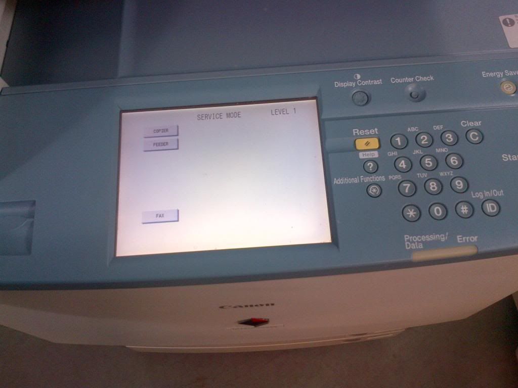

    So this is another irc4080 that I just purchased for resale and there is a little problem, this screen shot seen here will not update, everr.

            Sorry for the late reply, it's been a crazy month but thanks for all of your help guys. Though after using all of the previously mentioned tricks and potions, the irc 4080 copier is still not excepting the H1 colorpass. Here's another interesting screen shot:
            The funny thing is that I don't have a fax hooked up to this copier, nor a fax board, but also I noticed that the network board is not mentioned in the list. Should I just do a big ram clear? Thoughts?

              Looking at your pictures, it looks like you have the Fiery DIP switches in the wrong position, see page 8 on the PDF below, they should both be down???
