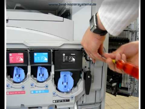

    What condition are the colour drums in? Look at the life % & also do a visual inspection

      We just bought this printer from a bankrupt company, so don't know the age of anything or the service history, but it looks like they are full(?)
      Please see the attachments for visual check. Not sure what I would call the condition.

          Thing is, all the drums and drum areas looks like that, and still only blue and abit red that are the problem. Black looks horrible, but prints out perfect.
          So i guessed it had nothing todo with that part. But i guess i'm mistaken?

            you are NOT looking at the drums. this is toner
            call tech please

              Exactly, your looking at the toner area, that's supposed to look like a mess!

                Even though it is in german, if you watch it will give you enough instruction to inspect the drums in the machine, I suspect they will require changing;
