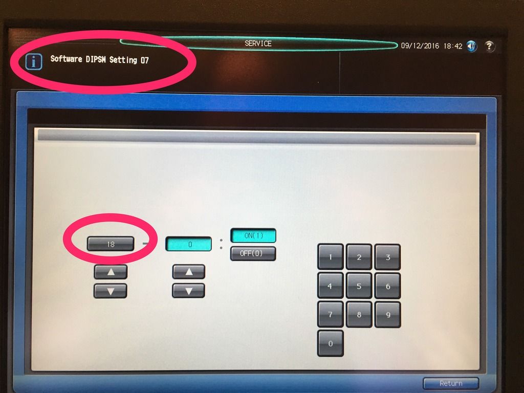

    Hi,
    Can anyone tell me how to disable a tray? We have a broken tray and want to disable it rather than having to press help and restart the machine every day.

    Re: C7000 Disable Tray
    Software switch 18
    Tray 1 bit 0
    Tray 2 bit 1
    Tray 3 bit 2
    Tray 4 (LU) bit 3
    Set switch to 0 for usable
    set to switch 1 to lock out.
      Thanks Synthohol,
      Are you referring to this screen? Also, is there a way to set all these back to factory defaults and do you have a list of what each does? (1-60)
        no factory reset afaik, yes thatsw the place to disable the tray.
        all the setting for each switch/bit are in the field service manual.
        yup your pic shows tray 1 is now out of order
