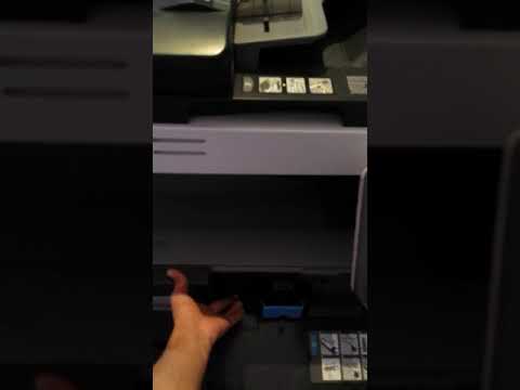

    [Electrical] konica minolta 423 ineo do not power on
    i have konica minolta ineo 4230 When shipped and subjected to stirring and now not running . The machine does not power on

    Are you sure machine was working before being shipped?
    Start with checking for loose cables on PCR or MFP boards. Also check that ram memory did not come loose during shipping.
    What your video shows is classic symptom of bad NVRAM. Try updating firmware with NVRAM reset tool
      Pretty sure ram is not going to come out considering the way it clips in.
      I dont ever want to meet the couriers who bangs copier around enough to let it pop out
