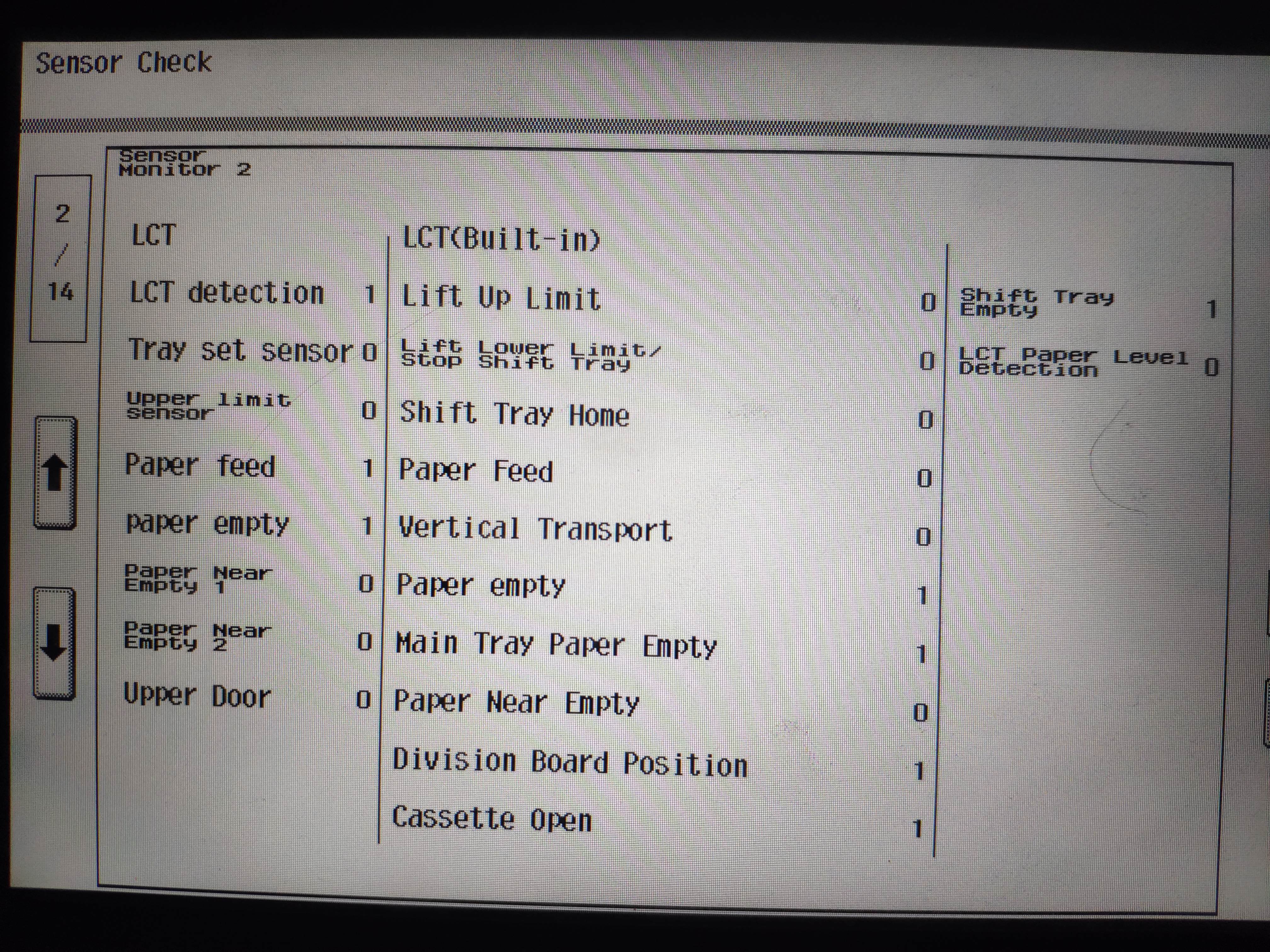

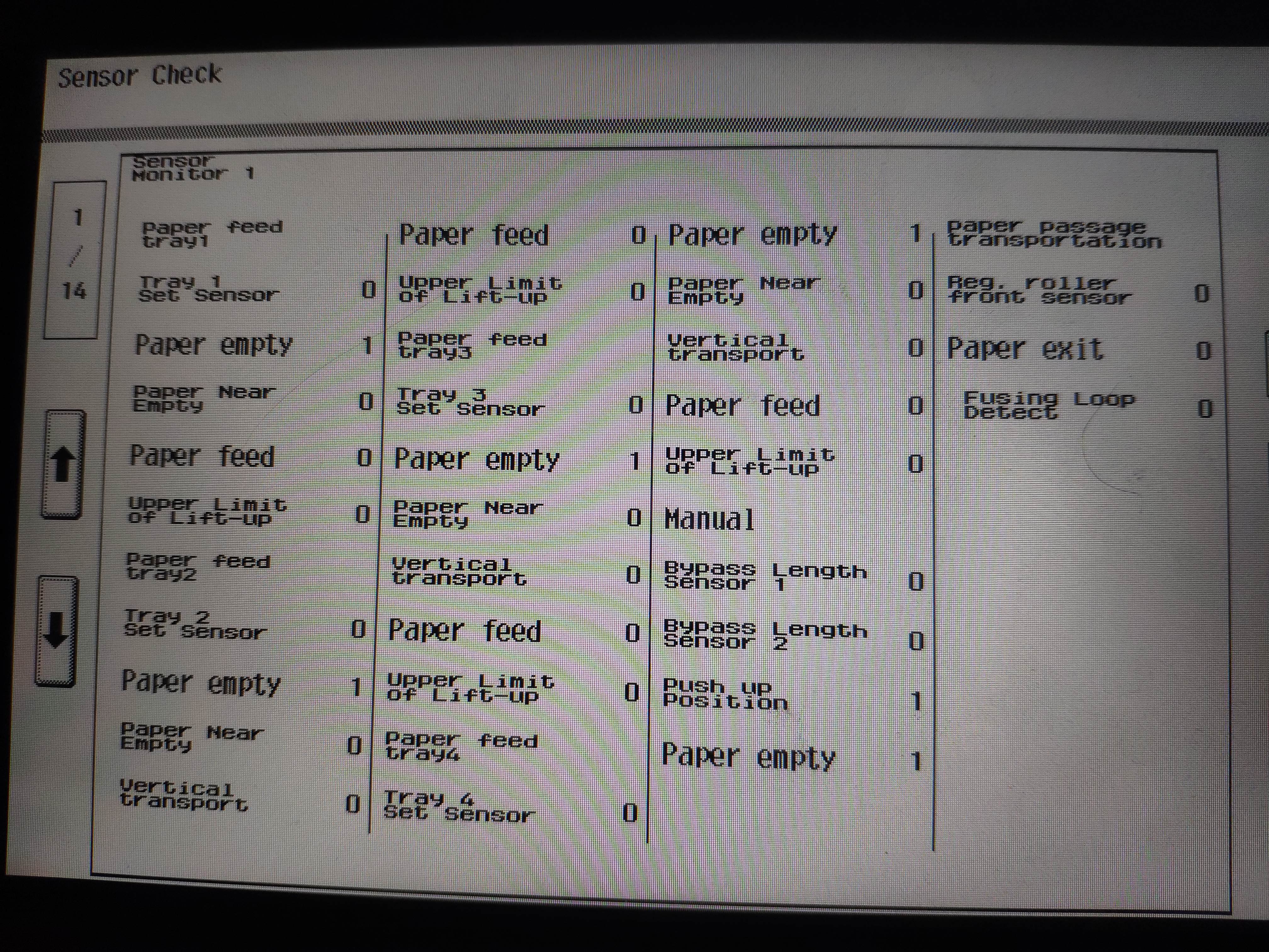

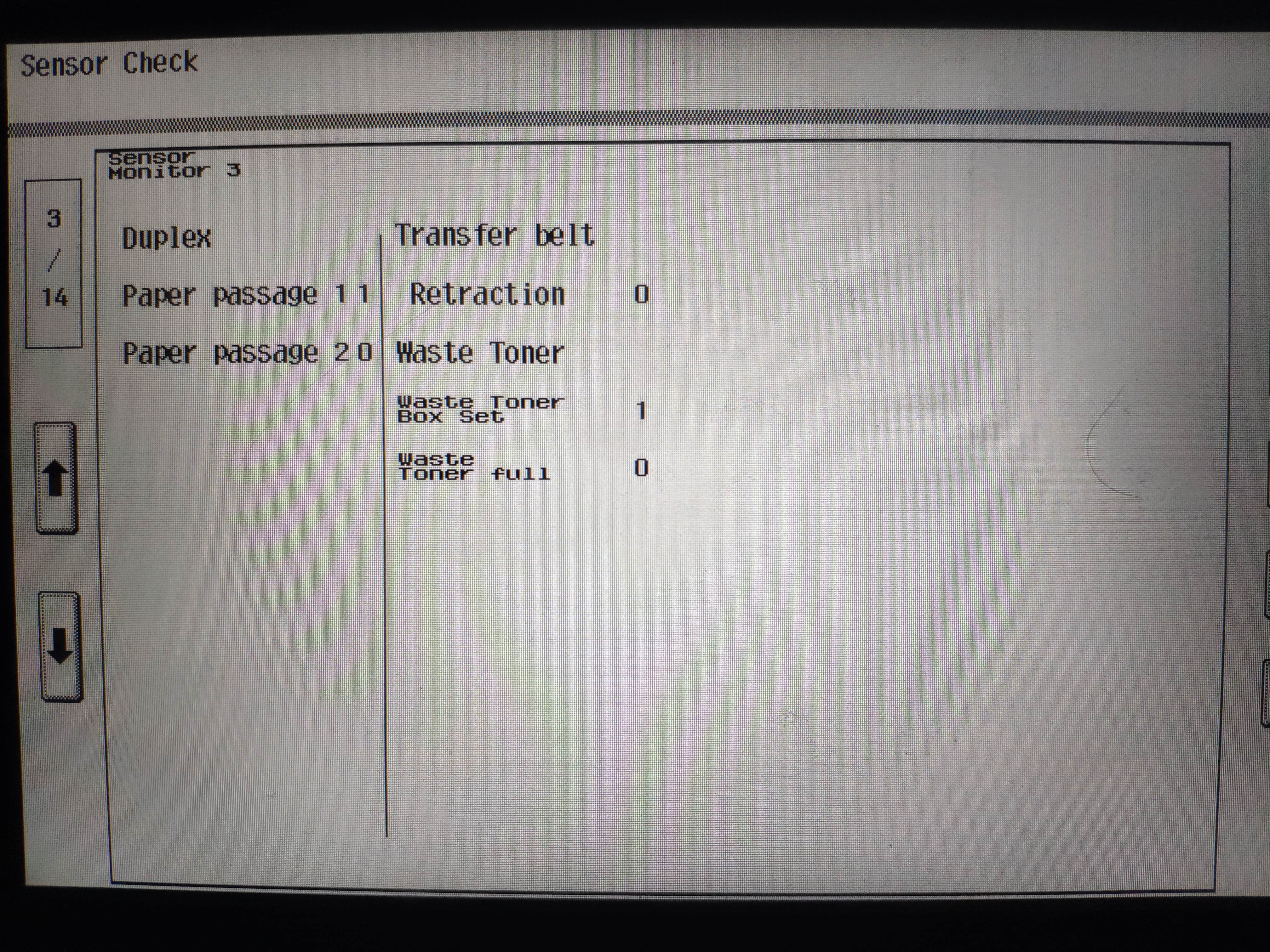

            I think I took the wrong pictures of my sensor check, here are the good ones.
            The PS3 sensor seems working.
            I'll look for the other possibilities

                      Re: Olivetti d-color MF-254 (=Konica Bizhub xxx?)
                      I confirm, PS3 is dead.
                      I switched both sensors to test it.
                      Now I need to find a photointerrupter quickly

                            Hope you got my PM
                            PS40 (1st duplex sensor) is activated.
                            Possible causes: piece of paper on actuator, broken actuator, spring out of place, faulty sensor.
                            For location of PS40, see the attachments.
                            Take off reversal unit and disassemble. PS40 is inside the unit; in the middle; behind PS3.
                            It's not that hard.
                            Good luck!
