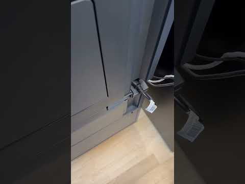

    Has anyone heard this noise:
    High Frequency. Customer says it only happens with duplex print. But I'm not sure.

                Yesterday I was there and first I printed the counter list. No noise. Then I printed the c-m-y-k gradiation pages (all 4 in one step you know). With cyan, yellow and magenta noise was there, with black not. Then I lubed all drum axes with oil
                on front and rear end. Noise was still there. Then I tried with load check all motors and so on. No noise. Then no noise any more. My two colleagues who where there before me had the same issue. Noise was gone after some trying and testing.
                Today customer phoned us. Noise is here again.
