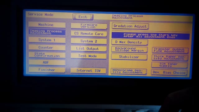

                      • rizwan143
                        • May 2015
                        • 42
                        Re: Bizhub color difference correction ?
                        Originally posted by allan
                        The settings you can change from photo shop is called color profiles. The machine is only CMYK. Use RGBs from your computer.
                        If you are in service mode goto image process adjustment -> gradation adjustment, run stabilizer first and then start from the top for copy and print, older machines is stuff like resolution and high compression mode. Follow the instructions on the panel.
                        My panel is this & need some more guidelines from you please.
                          You can do initialize and stabilize. Then do the 3 buttons under gradation adjust. Load the machine with A3 paper and press the start button its going to print out a page that needs so be set on the scanner. Putt about 10 sheets of A3 paper on top of the original and scan. Repeats each of the 3 buttons 3 times.
