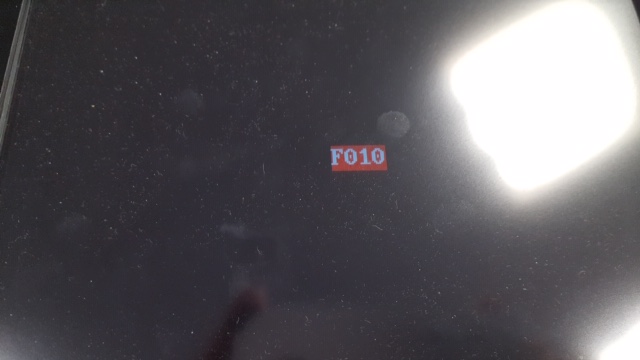

    Greetings and hope you had a great Thanksgiving,
    I have a Copystar CS3511i that is currently down, it is 7 months old.
    You turn the machine on, you hear the normal drive noises, the screen goes to welcome, stays on welcome then goes to a black screen with F010 in the middle.
    You obviously can NOT get into simulations, talked with tech support (almost useless) and they had me:
    1) replace Hard Drive
    2) Replace Main board
    Now they are saying it could be the SSD board that sits on the main board so that is on order.
    So I have to things to throw out at you guys.....
    1) Is it possible that the SSD board can cause this or have you ever seen this before?
    2) When I replace this SSD board (which holds the firmware) next week, will this machine boot with no problem since I could not 917 back up any information as the machine was down in error.
    Thanks

          • pjdbm
            • Sep 2007
            • 360
            Re: Copystar CS 3511i with F010
            This is what the screen looks like
                Gene, thanks so much for your reply.
                On these machines, there are no numbers to enter the codes. You have to click a # button and the key pad will appear in the touch screen. This does not happen because it is in a black screen as shown. Pressing the numbers pad does not work.

                        • pjdbm
                          • Sep 2007
                          • 360
                          I just got a TA-3212i (very close to the 3511) and tried it. If you leave the door open when you turn on the machine it warns you before it can run its self diagnostics. The touch screen appears and when you press the Numeric Keyboard button it appears and works. You should then be able to enter maintenance mode and run U024 format HDD or SSD.
                          Gene, I tried this today and it did not work. When this F010 is set, there is no getting pass this.
