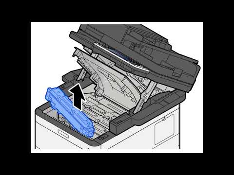

    Hello guys,
    I just installed a new Kyocera TASKalfa MA3500ci, this equipment is very similar to the TA352 but with improvements, however, it should be noted that the toners cannot be removed, the toners can only be replaced when the machine detects that they are out of stock, just like the TA2552 series, does anyone know what simulation can be unlocked to be able to remove the toners in the new model?

    Re: NEW model TASKalfa M3500ci blocking toners
    same as Iris
    U159 or manually after removing from upper left cover, there you`ll find unlock plates

      Thanks for the information,
      I will check the U159 simulation..
      as soon as I do it manually, if you have technical information on how to proceed I will
      thank you.
        [QUOTE=masky;2488352]大家好,
        我剛剛安裝了一台新的京瓷TASKalfa MA3500ci,該設備與TA352非常相似,但有所改進,但是需要注意的是,墨粉無法移除,只能更換墨 粉當機器偵測到缺貨的時候,就像TA2552系列一樣,有人知道新型號中可以解鎖什麼模擬才能 去除墨粉嗎?
        <謝謝[/引用]
          [QUOTE=csliao;2489011]
          Originally posted by masky
          大家好,
          <謝謝[/引用]
          Even though your intention is good, your message is not the issue of the origin of the problem, nor does it refer to the name of the post, here we are talking about how to unlock the toners once installed,
          we are NOT talking about how the toners are installed, something that is Very simple
