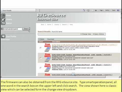

            Re: Ricoh mpc3003zsp android ui
            Hi Gents,
            Looking for assistance getting a new Z Panel machine setup - heard its got direct wireless capabilities and wireless capabilities as well but does anyone have guides on how to set this up and use the available features?
              • 37390
              I think that you are referring to Ricoh Smart Device Connector. This might be what you are looking for: Smart Device Connector Installation and Support Guide. It is available in the US from rfg-esource.ricoh-usa.com, rfg065496. You might want to check Ricoh for your region for how to obtain a copy. One word of caution, if you are planning on setting it up on your office network to test prior to delivering to the customer, you are going to have trouble at the customer unless they are using the same IP subnet. If not, you will need to find out how to remove and reinstall all network setting for the SOP/RSDC.
              Here are some video nuggets that might help:
              Smart Operation Panel Installation
              Smart Panel OS Update
              Smart Panel Application Update
              And a link the Ricoh Click2Learn Ricoh Click2Learn. It has a number of downloadable exercises for Smart Device Connector and Integrated Cloud Environment.
                Once again Thanks slimslob - I am really struggling to find information on how you actually go about setting up the Ricoh Smart Device Connect app. I mean I have it installed on my iPhone and I have the device connected to the same WiFi but cannot get the two devices to communicate what so ever.
                I'd have hoped that Ricoh would have released instructions on how to do all of this but it appears to be a secret.

                  If I remember correctly, with an android you have to scan to setup your phone the first time only. With an iPhone, you have to scan each time you want to use it.
                    actually with the droid you scan for the initial setup, but then for use you can connect via the NFC tag or scan the QR code............
                      Scanning the QR code was what I was referring to. I had to scan it the first time I connected, after that I just had to use the NFC tag. I think the documentation said that iPhone needed to scan the QR code each time to connect.
