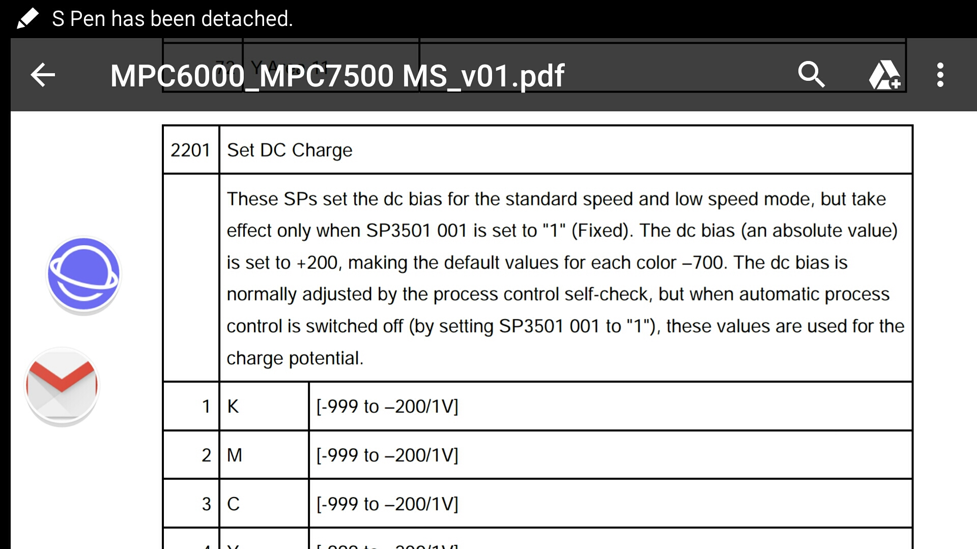

              • Guest
                Re: MPC6501 doesn't save the changes in SP mode
                My guess is that SP 2108 is for testing purpose only. SP 2201 is labeled as DFU which mean Design Factory Use. Stop trying to so things that the machine is not designed to do.
                Not marked in the service as DFU
                And stable in mpc6000

                      First your original post had to do with SP 2108. If your problem is back grounding, you should have started with that and asked how to correct that. That is easy to answer and does not require f***inf with SP settings that have very little to do with causing back ground. SP 2201 and SP 3301 are not related. Changing 3301 to fixed is to be used when the toner density sensor on a development unit has gone bad, and only until you get a new development unit. In fixed mode, the machine will tend to overtone and thus increase back ground. To correct for back ground, follow these steps:
                      1. Clean and inspect the drum unit. If there is less than 10mm left on the lubricant bar, PM the unit.Same applies to the ITB cleaning unit and the PTR unit.
                      2. Apply all bulletins dealing with image quality and toner dropping. There are quite a few for the C6501 which is a toner belching beast by nature.
                      3. Partially change the nature of the beast by changing the correct SP settings. The ones you are using are not the correct ones. See the attached starting with page 10. This document was given to me by our then regional support person.
                      Service Program (SP) Settings.pdf

                            Thank you slimslob
                            your Pdf help a lot
