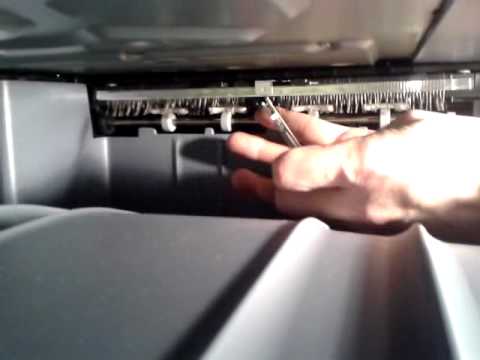

    Re: Sharp mx-m264
    This is the sensor I'm talking about, those stupid gray plastic parts fall off and then you get the "center tray" crap. My opinion it should be called something different *shrugs*

        Re: Sharp mx-m264
        Hi
        Have same headhache , finally find something?

          #19
          Re: Sharp mx-m264
          Originally posted by Maxx
          Hi
          Make sure dilivery sensor (the sensor all the paper that has exited the machine sensor which sits in belly with all exited paper on top of it is working and is the correct one. Found out the hard way that the mxm 260 sensor was put on this after sorter was taken off 264.hope it helps Dave

            #20
            Re: Sharp mx-m264
            Check sim 26-1 to see if some one has turned on the job seperator option this will give you that message if it is on and no seperator tray is installed.

                #22
                Re: Sharp mx-m264
                Originally posted by davebtech
                Sharp mxm264 has ( remove paper from center tray) on display never scene this before,no paper there,no finisher,no Jams in dilivery unit, or fuser. replaced paper sensor above laser unit in dilivery tray(center belly of machine) replaced paper sensor in dilivery unit.This thing won’t go away. Anyone see this before? Thanks for any input ,Dave
                Check 26-1 if its enabled and there is no separator tray this will be the issue

                  #23
                  Re: Sharp mx-m264
                  I have the same problem, now for a 2nd time - that TFD1 sensor (center tray paper present sensor) stays active 100% of the time. You can get fooled if you power down the machine, the copier's internal count of how many pages have exited into the center tray without being removed, will be reset to zero. Drove me nuts on a new installation, where we had removed the MX-FN23 to simplify the machine. A couple days later, the copier said "Remove paper from center tray". Power down the copier and the message goes away. 500 pages later (or whatever the number is) the message comes back. We ended up re-installing the MX-FN23 finisher. Now I have another MX-M314N to install, and the customer doesn't need a finisher, but I am unable to get that TFD1 sensor to function. And contrary to what someone said, it is identical sensor (VHPGP1S73P+-18) as in use on the MX-M260N.

                    #24
                    Re: Sharp mx-m264
                    [QUOTE=yurisan;795538]I have the same problem, now for a 2nd time - that TFD1 sensor (center tray paper present sensor) stays active 100% of the time. You can get fooled if you power down the machine, the copier's internal count of how many pages have exited into the center tray without being removed, will be reset to zero. Drove me nuts on a new installation, where we had removed the MX-FN23 to simplify the machine. A couple days later, the copier said "Remove paper from center tray". Power down the copier and the message goes away. 500 pages later (or whatever the number is) the message comes back. We ended up re-installing the MX-FN23 finisher. Now I have another MX-M314N to install, and the customer doesn't need a finisher, but I am unable to get that TFD1 sensor to function. And contrary to what someone said, it is identical sensor (VHPGP1S73P+-18) as in use on the MX-M260N.[/QUOTE
                    sensor is the same but the small 3 inch long wire harness that connects it is different than the mxm 260

                      #25
                      Re: Sharp mx-m264
                      The MX-M260N and MX-M264N center tray, paper present sensors are wired differently. If you want to put a MX-M260 center tray on a MX-M264N/M314N/M354N, the solution is a simple one - just cut and cross-connect the brown and orange wires. You can leave the gray wire alone.
