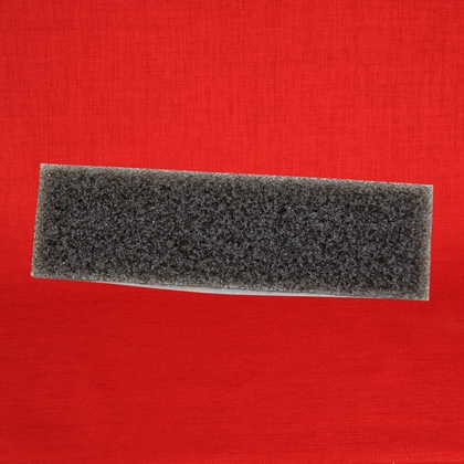

    Tray one is bending paper and jamming. The more full the paper tray is the worse this is.
    Any ideas?

      That has been check....My tech thinks the seperation pad may not be the right size and or thickness. FYI the pad is OEM.

            Sharp PSHEZ0242QSZZ, GPAD-0001QSZZ, PSHEZ0378QSZZ
            PR Order #
            J3710
            This is the right pad,make sure they did not use the cork pad meant for the tray.
