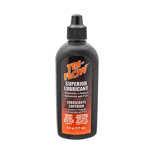

                              you could pull drums... clean corona .. gears on drum(s) and inside unit. on gearing a tiny bit of Triflow on the pivot points. ( WIPE ANY SPILLED OIL ) I let the Drum(s) sit for a bit on shop towels before reinstalling
