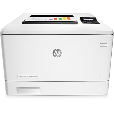

    Hi everyone, I'm a Sharp/KM tech but have been asked by a client to look at at HP M452 as its very noisy and keeps showing a 59.0240 error and another code they are convinced has a F in it?? I have checked it out and no noise was apparent when i was there and I said I would check out what the error code points to and let them know from there.
    ANy help greatly appreciated - the meter count is 59K
