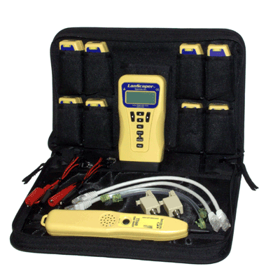

              Re: RJ45 Pass Through Connectors
              I have a LanScaper kit that I got when I was in Iraq in 2005. It came with 8 numbered remotes. The screen on the main unit displayed the number of the remote and the wiring of each end. When doing a new install you could put a remote at up to 8 location and identify them at the distribution panel. Could also test patch cables. No longer available but NOYAFA may have something similar.
