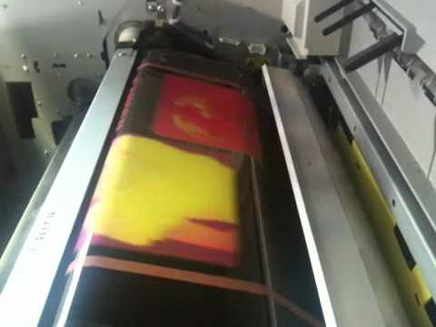

            TRANSFER SEPARATION
            A '2570 with it's ITB (Intermediate Transfer Belt) visible. It lays down each color in turn before transferring the complete image onto the paper.

                    Re: Very poor print quality on Canon iR2570
                    Thanks for the link to that document - I managed to get the finisher off properly and get to see the ITB during machine operation. I think I've got a lot more information now that should help in diagnosing the problem.
                    Basically, the image is coming up on the ITB properly - almost perfectly. There are a few drop-outs here and there, and a few lines occasionally on the large expanses of colour on some of the test sheets. Things like the grid pattern (test sheet 6) come out very sharp on the ITB. However, they are still coming out very poorly on the paper.
                    It looks like the problem must be somewhere between the ITB and the finished print coming out of the machine. From my understanding of the service manual that means the fixer, or the secondary transfer roller. Does that sound correct? If so, how would you recommend checking the operation of these parts? Is there some way that I can get access to those bits while its printing and see at what stage it goes wrong? (I somehow doubt that, given that the fixer is at about 200 degrees!). Or alternatively, can I adjust the secondary transfer rollers somehow and see if that fixes it?
