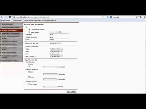

        Re: Tracking Copies and Print made based upon User Box
        account track is what i think you are looking for. its in admin mode.
        you use a unique password for each user and it logs the activity done under that number.
            Account tack like Synthohol mentioned will work.
            But it will not track the user box activity and no 3de party solution i know off will do that.
            If the machine is accessed with a account code that will be tracked under that account.
