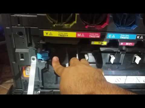

        Not English but found this on youtube.
        This is how i reset these units. The tool he use makes a dead short between pin 1 and 5 for dev tank or pin 1 and 3 for the drum.
        Sometimes i would change out the ICP's.
        The C280 you can do without the waste box. The C224 needs the waste box installed.
