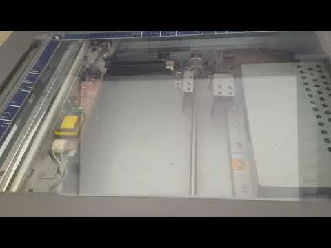

bizhub 600 boot not completing
  • manzoorwighio
    • Dec 2019
    • 28

    Re: bizhub 600 boot not completing
    Does scanner lamp turn on during booting?
    I think it should be turn on,if not check scanner lamp,inverter board...?
      When Scanner lamp turn on boot complete . But when doesn't turn on not boot compelete
        that model is at least 14 years old. the battery must be shot by now?
          There is your solution,i would try replace lamp first.
          Have same problem on other newer model and it was faulty lamp.
            Try to update the firmware on the card. I've solved problems like this one by updating
              Updating, or just re-flashing it. We very frequently had issues with the CF cards getting corrupt in these.
                The lamp should turn on to read the white pattern when it's under the slit glass, I don't see that happening but before you even order a lamp as I read on other posts flash the firmware. That should help with the freezing up issue, once you try that then follow next problem.
