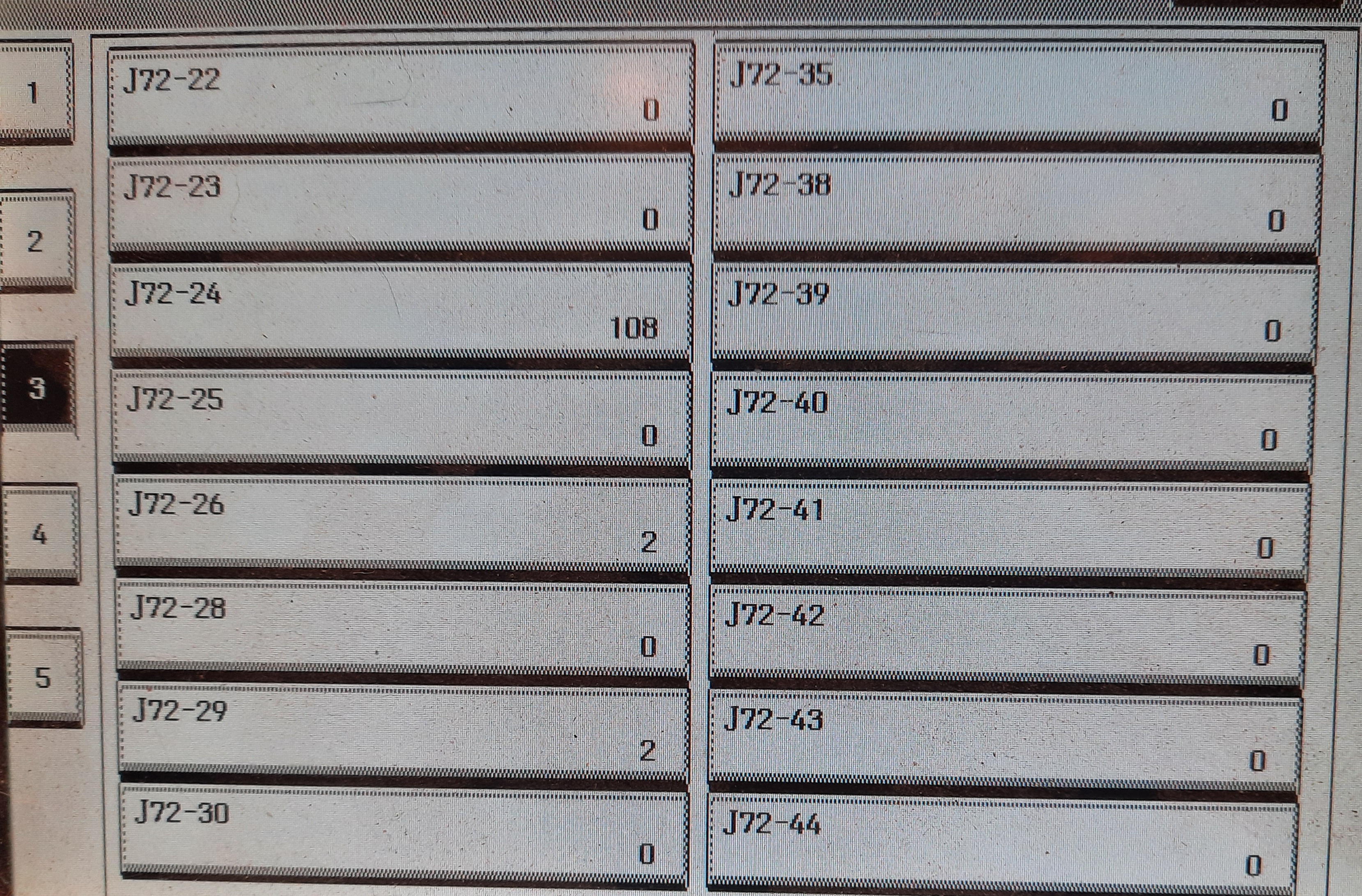

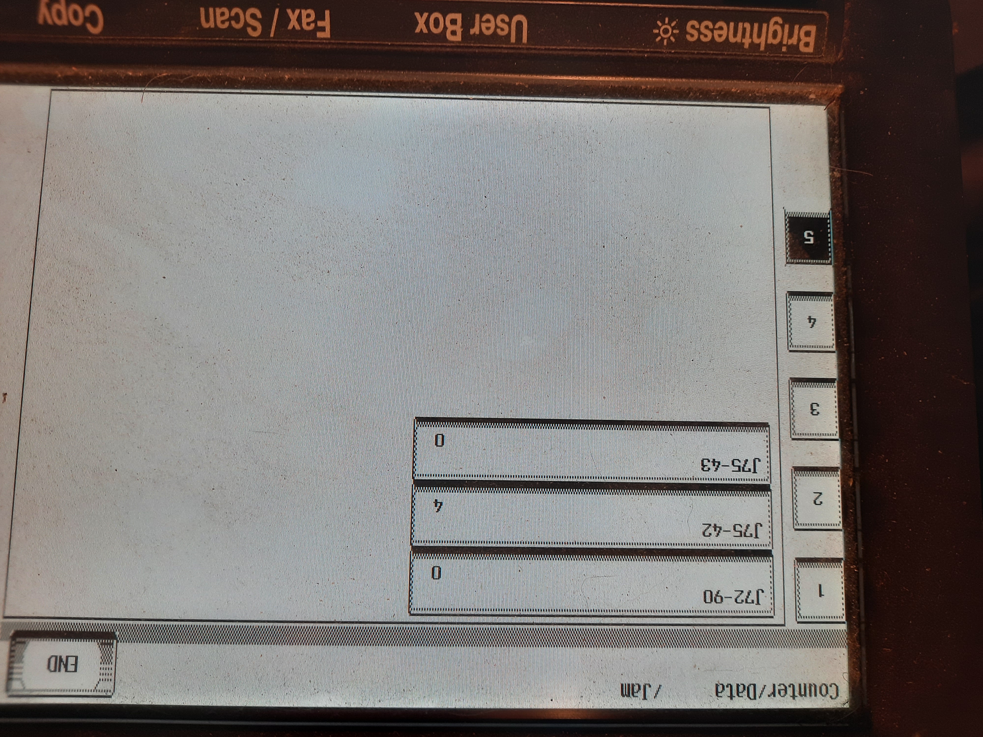

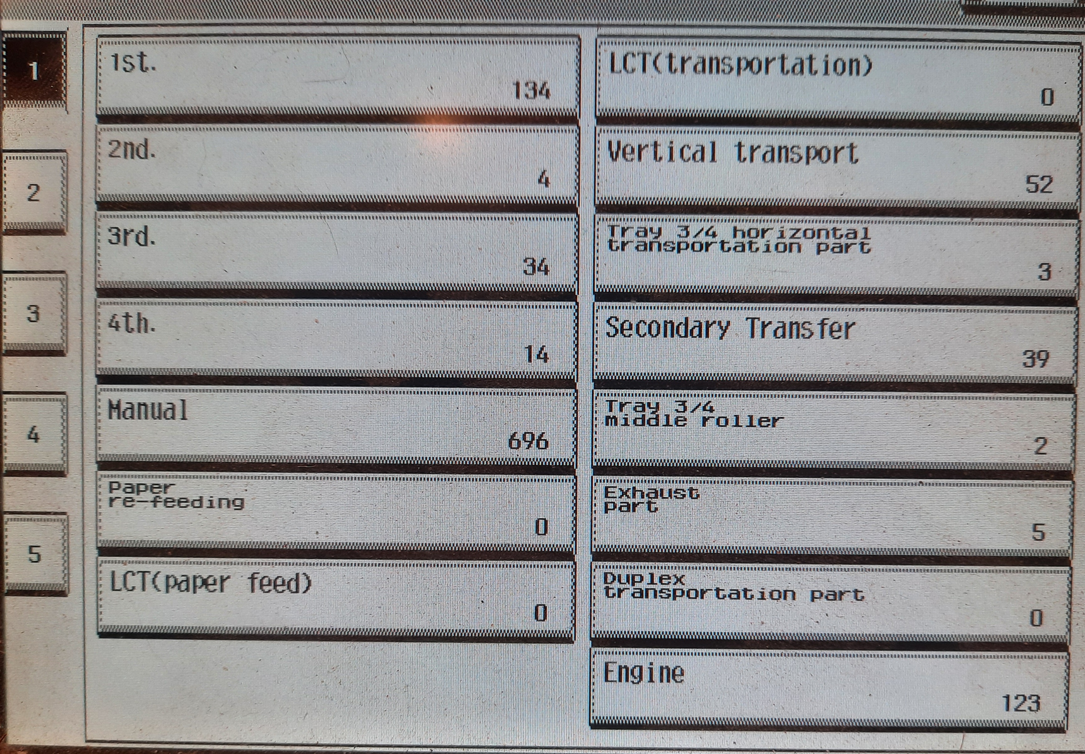

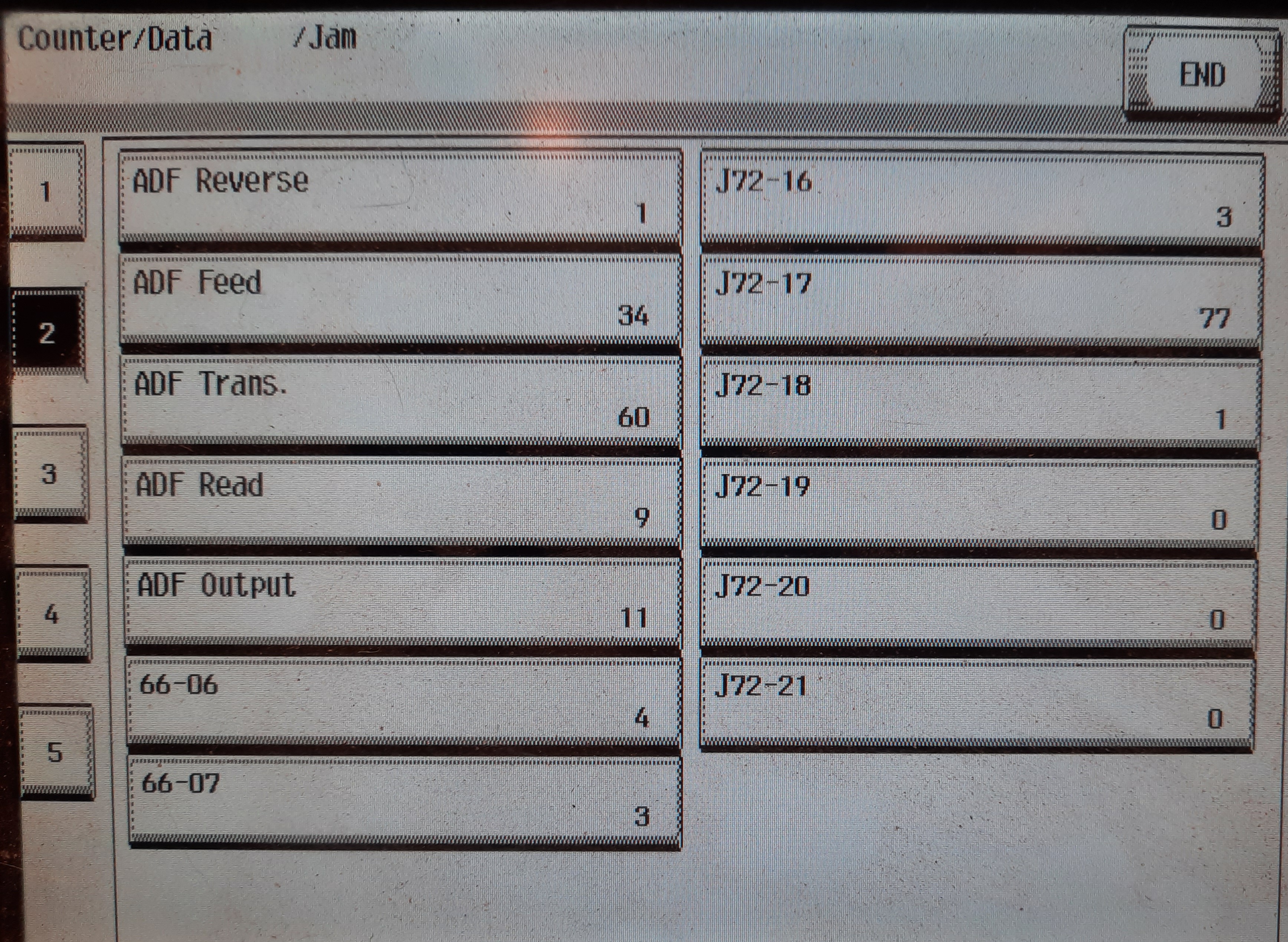

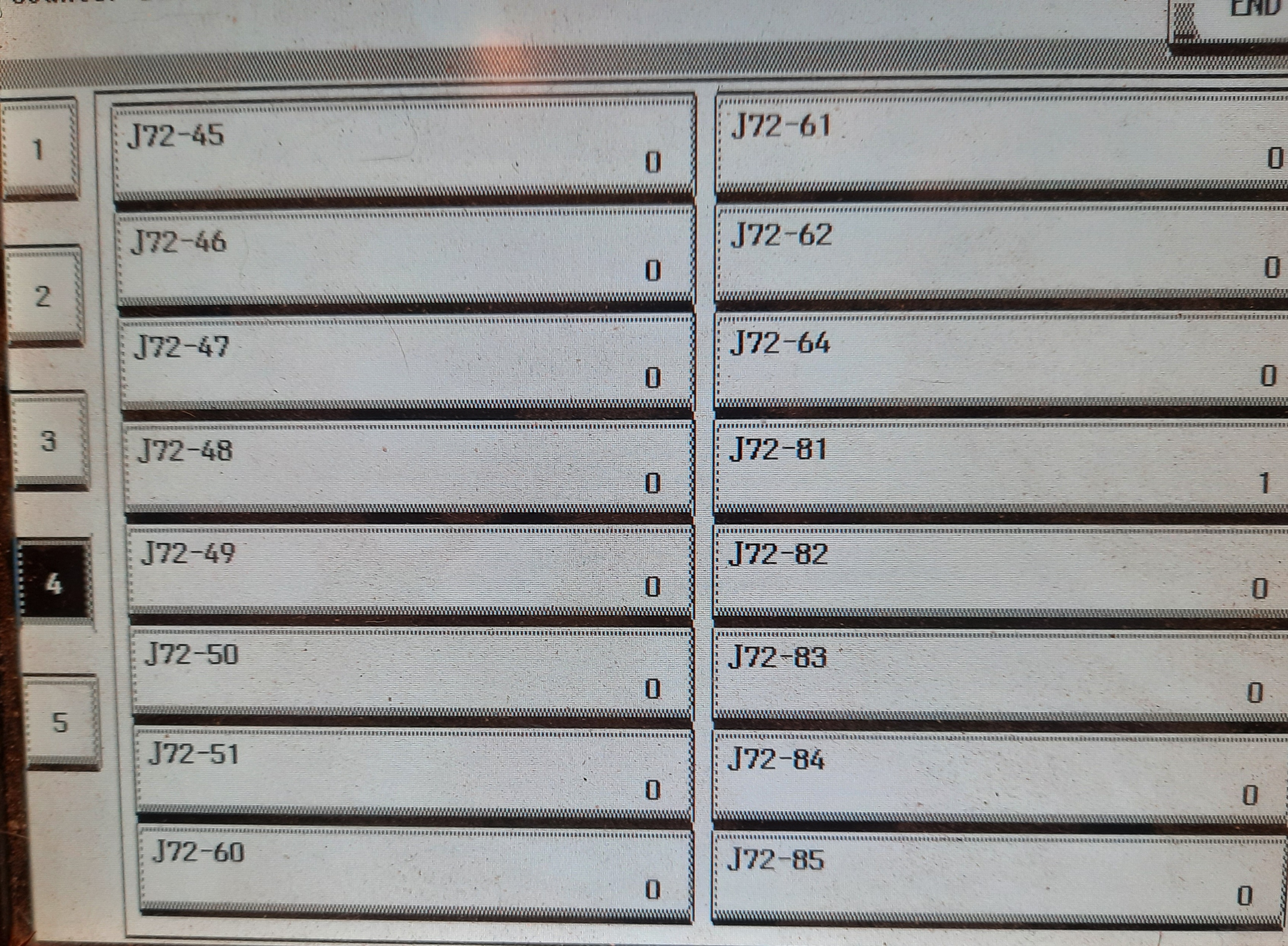

                I think I'm getting close. You've been extremely helpful. Not sure if I got the jam codes from the right spot. The following links are to photos of the 5 different screens available. Sorry about the external links, I could not get these images to upload to copytechnet. VillageofManito.com is a website I run for the village I live.

                  Those are the wrong area. That jam section just tells you how many times each jam code has happened through the lifetime of the copier. You need to select the area that says something to the affect of "Jam History". This will give you a list of jams in chronological order, starting with the most recent. You will know you are in the correct area when you see jam codes (J####) with a date and time next to each one.
