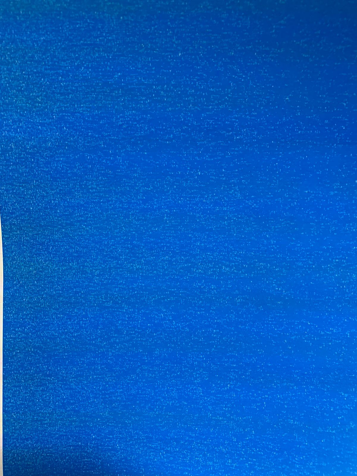

    [Misc] cyan failing konica minolta
    whats the problem here?

          I have a konica minolta c458 and the cyano is printing like this.

            Oh great God of the digital print, I'm sorry for failing to detail the problem so that your great wisdom can help me. I couldn't explain the problem so I decided to post a photo so that the Great Gods of digital could see what was happening. After trying everything that my inconpendent wisdom could solve and tired in the early hours of the morning and discouraged at not being able to solve the problem.

                  blackcat4866 Thank you for your words and for your attention to my problem. This file I will keep it forever for print tests.
                  Just before your post I removed all the developer powder from the unit and topped it up with an old one that I had previously used here and was in storage.
                  By adding the exact amount of developer powder, the print improved by 95%, but there were still white dots. I come to the conclusion that it was a lack of developer powder when printing 100% cyan.
                  When printing your file, the printout was 100% perfect.
                  I have a follow-up question.
                  Why and under what circumstances does the developer powder decrease and what can I do to prevent this from happening?

                      I've seen Ricoh color models where the only regular use of the color PCDUs was during process control when first turned on in the morning.
                        Same here.
                        We had customer or two using bizhub C224e almost only as mono color machines for a extended period. I mean 1.5 million and they never fail. They did only stabilizations and nothing more. We set them as stabilize per mono color priority though.
