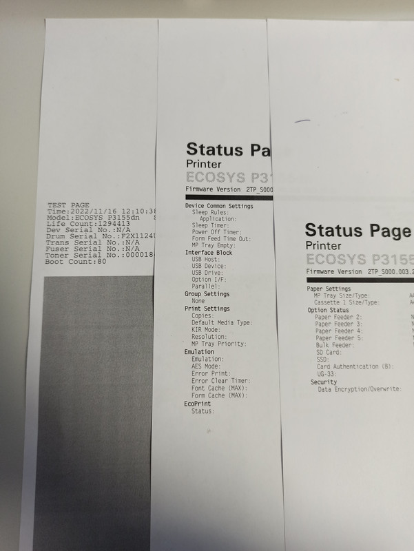

    Hi all,
    I have a problem with top blank space on paper when printing on Kyocera Ecosys P3155dn. Its not only on first page but on every page.
    Its happening even if I just print test page on printer.
    Any suggestion is welcome!
    I will put link here for you to understand better: https://i.postimg.cc/50hwMTLk/IMG-20221116-141548.jpg
    Thanks!

    Re: Kyocera Ecosys P3155dn - blank space at the begining of each page
    Looks like registration is off? Have yo tried through the bypass to see if you have the same issue?
      Yeah I tried through bypass and its still the same.
        Check registration roller / clutch to make sure it is not sticking and driving continuously.
          I checked registration roller/clutch and everything seems fine.
          Still thanks.
          Only thing that is strange is that something is very loud and there is crack sound every time it prints something.. need to check that..
              With that many prints on the machine, replace the registration actuator. I have not seen this cause the problem you are having, but it will cause intermittent jamming starting sometimes around 750,000 prints. It may not look worn until you remove it and put it beside a new one. I generally recommend replacing them about 750,000 prints just to prevent jamming issues that will get worse with time. Hope this helps.
                The registration clutch and bushings should be DESTROYED at 1.3M. At 1M the bushings oval out, the rollers lose contact and the gears disengage. Also the registration actuator can be cut completely off, not just grooved.
                If I remember correctly there are no part numbers listed for the bushings. I reached into my 5 gallon bucket of miscellaneous bushings to find (4) that fit. =^..^=
                  Thank you lees I will definetly try your sugggestion! Nothing to lose here :P
                  Thank you blackcat4866 for the info I will try to find the culprit :P This printer is well maintained, last big maintenance was on 1M. But yeah anything could be wrong by now... Still want to fix it!
                  Worst part of this "error" is that there is no any info on web and I have never seen it so I tried on this forum!
