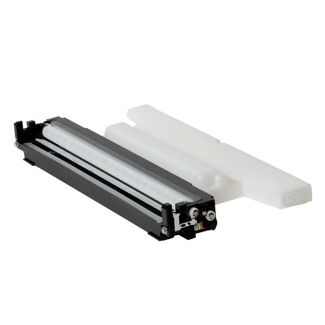

    Hello,
    I have this type of mark on a RICOH Aficio MP C2050.
    Which component or part should I clean to resolve this problem?
    Thank you.

    • 37553
    ITB cleaning unit
    Unité de nettoyage ITB

      Thanks.
      I cleaned the ITB CLEANING UNIT.
      It's in good condition, the squeegee is clean, but that didn't change the problem.
      The "fabric" roll is also in good condition.

        Is this the Transfer Belt Cleaning Blade?
        Est-ce bien cela la Lame de nettoyage de la courroie de transfert ?
          • 37553
          Those three streaks are the ID sensor patches. There is no way they should still be on the ITB during a print unless the cleaning unit is not functioning correctly. Make certain that you are using a Genuine Ricoh part and not an after market one. Also make certain that it is for the C2050 and not for the C2051 as there is a difference.

            I've had this copier for several years; the part is original and has never been replaced.
            Do I need to replace this part?
            Do you think cleaning it is not enough?
            J'ai ce copieur depuis plusieurs années, la pièce est d'origine et n'a jamais été changé.
            Je dois changer cette pièce ?
            Un nettoyage n'est pas suffisant d'après vous ?
              • 37553
              The ITB cleaning unit should be replaced ever 60K for a machine that is used within the targeted monthly usage of 8K to 50K. If under utilized then it needs to be replaced after one and a half to two years. The blade material will soften with age.
                Yes. Replace that unit
                  Yes.
                  Replace the unit
                  Think of it like the wiper blades on your car.
                  They may still look good, but not clean worth a damn

                          Hello,
                          If I only print in black and white, once the transfer tape is clean, I no longer have any streaks. But only in black and white.
                          Could the problem be elsewhere?
                          Bonjour,
                          Si j'imprime qu'en noir et blanc, une fois la bande de transfert propre, je n'ai plus les traces. Mais seulement en noir et blanc.
                          Le problème peut-il être d'ailleurs ?
                            • 37553
                            That is because color alignment, the diagonal lines of the ID patches, does not need to be done.
