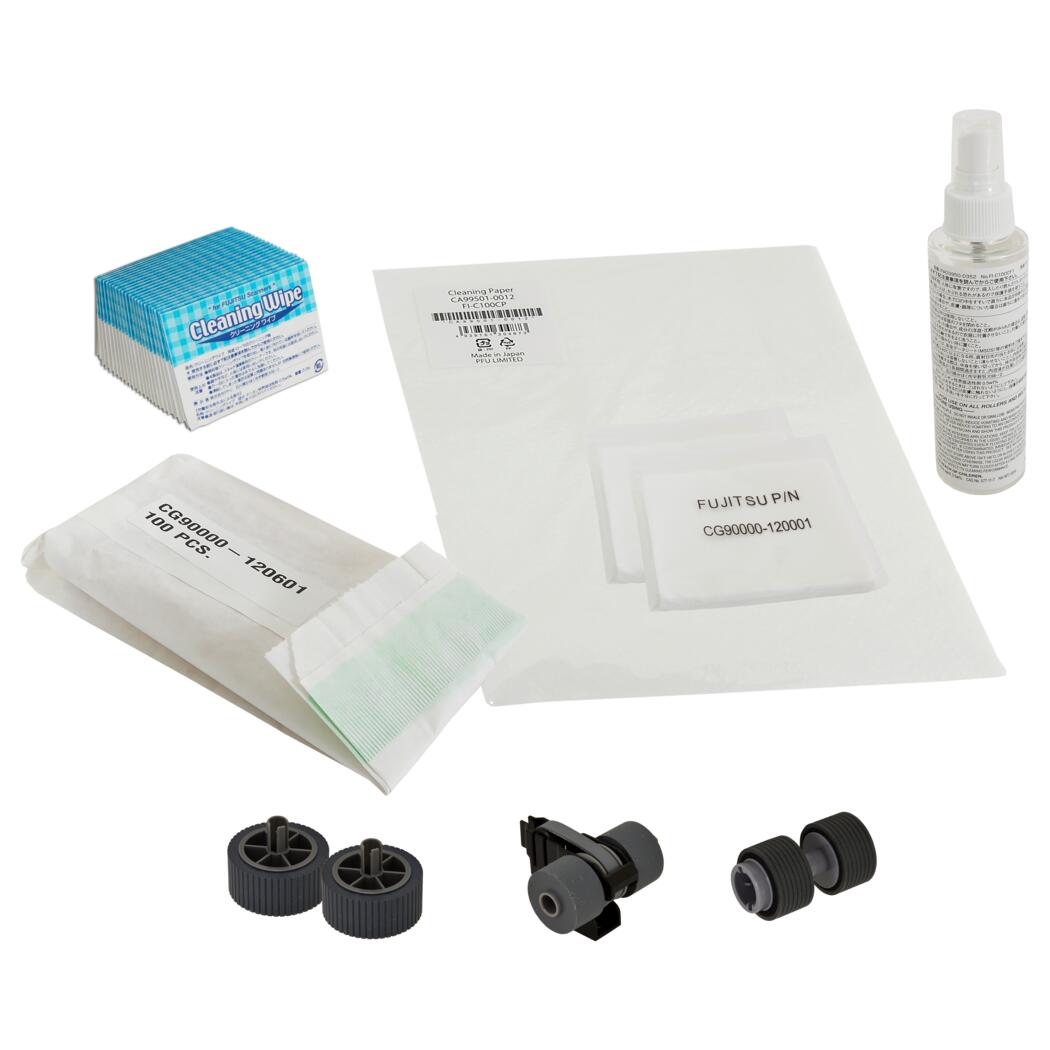

    Fi-7700 scanner slowing down when scanning more than 10 scans plus it pulls more than one page at the same time

      I cleaned the sensor but the issue still exists, which it drags more than 1page in the scanner

        Don’t know this model but replace the feed and friction parts.

            i dont know that model, but you can easily replace the follow part, in generaly fujitsu build a good scanner machine
            for the slow scan, try to play with resolution, gray scale, compression, etc. etc.
            Fujitsu fi-7700 ScanAid Cleaning and Consumable Kit, Genuine - Genuine Fujitsu Kit Kit Includes: (1) Consumable Pick Roller Set [PA03740-K011] (1) Consumable Brake Roller [PA03740-K010] (1) F1 Cleaner 100ML Bottle [PA03950-0352] (2) Cleaning Wipes 4X4inch 20-Pack [CG90000-120001] (1) Cloth Cleaning Sheets 10-Pack [CA99501-0012] (1) Moistened Cleaning Wipes 3x3inch 24-Pack [PA03950-0419] (1) Cleaning Swabs 100-pack [CG90000-120601]
