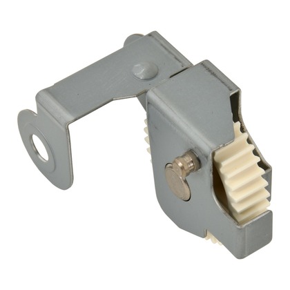

    But I found it, Bracket: Fusing : Drive P/N: B090 1170
    Yeah I know it's old, and it's tired, but it was still running until yesterday.
    Got a call about a noise coming from a MP2550.
    Soon as I heard it I'm thinking it's the fuser drive gear.
    Nope! It's the white gear driving the fuser drive gear.
    I've looked at the parts manual and I am beside myself trying to find it and where it's shown.
    I remember replacing that white gear in another Ricoh machine years ago. If I remember right it was a pain in backside to repair.
    Anybody out there got the answer?

        Thanks, on further inspection of #5 which is the gear above the gear I need.
        I needed this:
        Thanks again!
