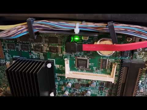

                        I switch on and I get the green blinking light on the front of the machine but I do get some lights on the board near the sd card as you can see from the video. The screen is dead though and it doesn't switch on. Based on all advice shall I move to the power board?
                        There aren't any fuses I can check on the board anywhere. I guess that would be too simple. It's a lovely paperweight at the moment!

                            I've looked at this guide to the lights on the board
                            Sharp MX-2614N, MX-3114N (SERV.MAN46) Technical Bulletin โ€” View online or Download repair manual | Not Booting Up Blank Screen Procedure
                            From this and looking at my new video below, my power light is normal (furthest light on the left), my sd card shows as fine as there is no light on and this leaves the lights next to the hard drive connector (at the top) and those right at the bottom
                            Both of those are blinking green and I assume if they were fine they would just be on. As such, all signs point to the power board.
                            If anyone feels differently please let me know. Otherwise I may now see if I can see if there are any obvious issues on this. Does anyone know the common failures?
                            Is it the caps for an easy repair? After discharging them of course.
                            I will start looking at this but any nudges in the right direction would help. Thanks
