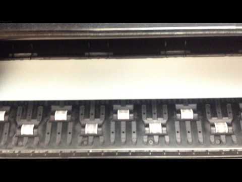

    I'm getting banding with all colors. Replaced some printheads (the ones with bad nozzels), ran head alignment, and ran paper advance calibration. Also tried adjusting paper advance. None of it seemed to make a difference.
    When I print out the test pattern, it looks kind of weird. I shot a video of it while it prints and am posting it below. You'll have to skip to the middle to see what I'm talking about, but you can see these white spaced while it's printing. I don't think I've seen one do this before.

      I'm not sure I'm seeing the problem. Is it this spot I've pointed to in the image?
      2016-05-06_1132 - Kiran_Otter's library for a larger version (not sure why it's so tiny on the forum)

                  Just my two cents, but it looks like there's one or more plugged jets in the print head.
                  If I remember correctly, HP wide formats keep track of plugged jets and try to compensate with other jets. It sure looks like that's what that machine in the video is doing.

                        This thing is driving me nuts.
                        If you look in the video, about halfway through the big blocks of color, you can see these solid white lines. Those come out as light bands in the end. Kiran mentioned the two lines of printheads, and I thought maybe it was normal and had something to do with that. But that's not the case. I watched another Z6100 do a test page, and it doesn't do that at all.
                        On "tech support's" suggestion, I replaced the carriage unit & carriage board. I didn't have much hope in that, and I was right, it did nothing for me. Still banding. I went through most of the manual's suggestions on banding, and it just doesn't seem like it's helping. When I run the paper advance visual test print, it looks almost normal. There was one line that looked weird, but I think I had tugged on the paper for that one. Everything else looks like it should.
