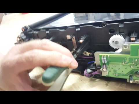

    Replaced ETB transfer unit and the message keeps blinking that it needs to be replaced. I have the manual and it doesn't refer to a way to reset the parts counter. The machine was off when the unit was replaced.
    How do I get the message "Replace transfer unit" to go away?

    Gotta replace the ITB or modify with a fuse. I just change itb not worth the BS.

      The belt assembly was replaced yet the message did not go away. It was a refurbed belt unit, may have to replace again

        since you had it powered off when Installed... open front door .. power off and back on if that doesn't work follow what Wild Bill said.

          They do make a device that will reset a belt if it was refurb. Use Google.

            Ye get another one cause you purchased it right? They Should stand behind their product. I have had 2 of those Refurbs take out the DC Controller, I think they put the wrong fuse in.

                    Try without resistor or by a new resistor. Cheap stuff.
